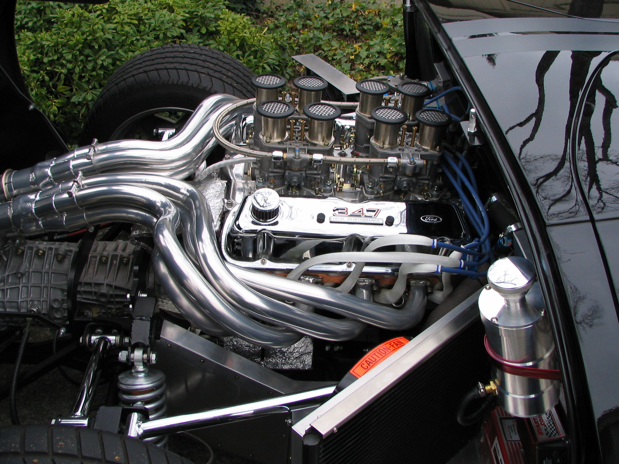

IDFs are slightly taller than IDAs. My IDAs have 2" spun aluminum stacks. I suspect 2" on IDFs will be close to maximum height for the rear carbs. I'd suggest you go with the 2" stacks.
Sorry, I didn't have a picture with the rear clip and window on.

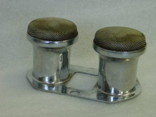

I have a set velocity stacks that measure 3" (top to bottom) on 48 IDF's. The very rear most stack slightly touched my rear window. Although, this could depend on where your motor is placed, I believe my motor sits about an 1" higher than some due to my Renault trans. Other tran's, i.e. porshe, ZF, allow the motor to sit a bit lower.
One note: under quick exceleration I get a lot of gas resdue sprayed on the rear window. A bit annoying.
(Hersh, this pic is one of the stacks I purchased and referenced in another thread yesterday)

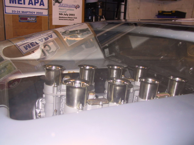

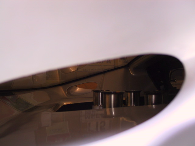

Fred, I have just installed Weber IDAs into Martin Weigolds car , the top of rear most trumpet is 95mm (4inches) below the glass rear deck window, photos if you want them, (You showed me that the rear trumpet on your car touched the glass and had broken it! )Frank
wealdenengineer is offline
Old 07-08-05, 06:04 PM   #13 (permalink)
wealdenengineer
Join Date: Oct 2001
Location: East Sussex, UK
Posts: 1,102
Rep Power: 0 wealdenengineer has a little shameless behaviour in the past
Re: Weber Stack Length
Fred, Picture added

Another pic
