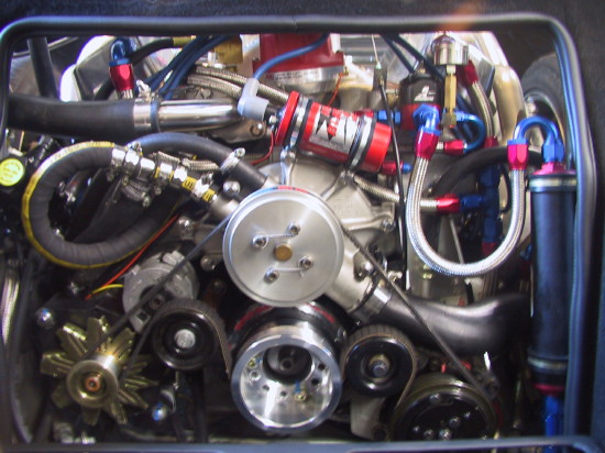

Short pump, standard rotation with no v-belts!
