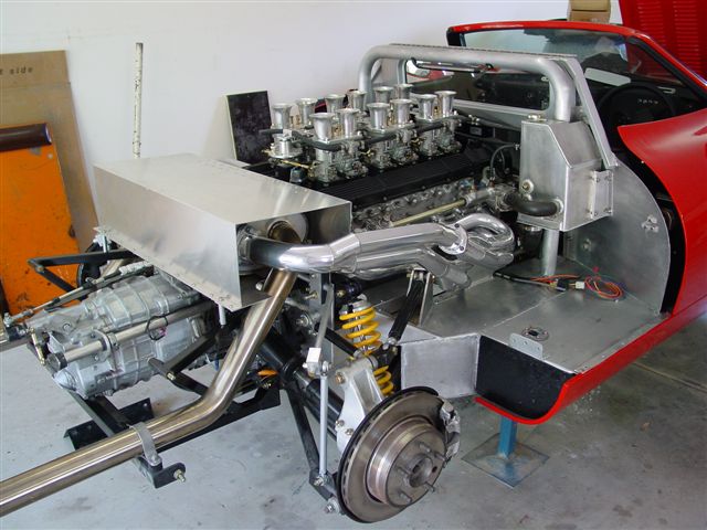

I don't know anything about tuning these things but I thought you might like a pic of this nice little group on the XJ13 they are 42 IDF Regards
DenisBedford is offline
Old 02-11-06, 05:25 AM   #20 (permalink)
Join Date: Dec 2003
Location: Original owner DRB Sportscars driven over25000 miles MK1Gulf replica now sold to TimTritton cur
GT40: Gold Coast AUSTRALIA
Posts: 91
Rep Power: 5 DenisBedford is on a distinguished road
Re: Weber costs?
I missed again
