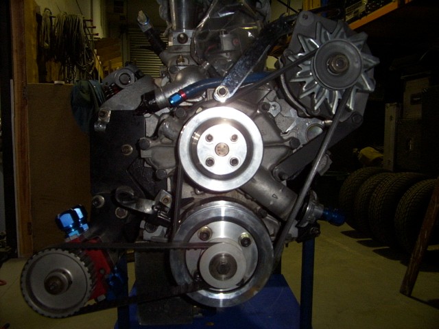

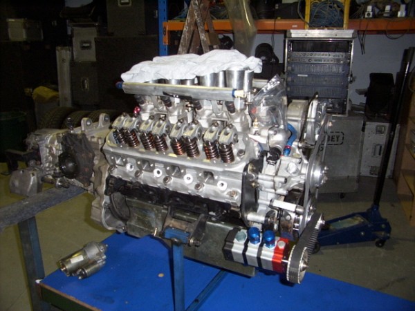

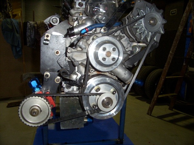

Here's my setup Tom.No pipes on the pump but you can get the general Idea
an air conditioning compressor ah! where can I put it? She's going back together after valve job. Good to see different Ideas.

As you can see from my pics I have a 3 stage pump, 2 scavenge the sump and 1 pressure.The 2 scavenge lines come from the sump to the pump and then a single line out of the pump through filter, cooler , Tank inlet. The pressure line goes from tank outlet to pump and pump to block direct. The filter is before the cooler to hopefully stop crap entering it and the tank. I have a temp sender in the tank. When I set it up I looked at many different Ideas but this one made sense to me.
