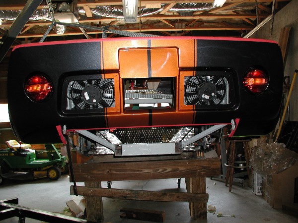

I got all my hoses and AN stuff off Ebay, but got the coolers from Earls(25stack, 10AN) and some 9"Spall units. Probably paid too much by the standards of the earlier post but they are killer looking. The spray bar and sprayers for the trans can be had from Aircraft Spruce. Haven't ordered mine yet. Still designing the mid trans mounts. Will pull the trans apart to lenghten the studs and drill for the sprayers at the same time.
http://www.aircraftspruce.com./menus/ha/fittings.html
Name:	Web P1010163.jpg

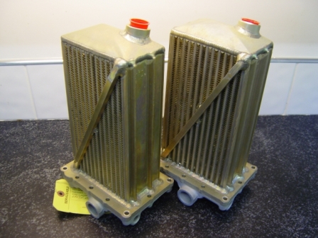

I had this done but did not trust the end results and ended up purchasing two new coolers from Pacific. I received substantial help there from Wayne who modified my coolers in manufacture by inletting nozzles into the tops prior to anodising.
James

Wow, those are structurally strong looking coolers!

James, they close to originals.
Who made the base plates ?
Any prices or contact details ?
John.

John,
These coolers were used on MKII's onwards.
I have now sold most of my original parts but I think I have some baseplates somewhere.
Send me a pm with your address.
Cordially,
James
