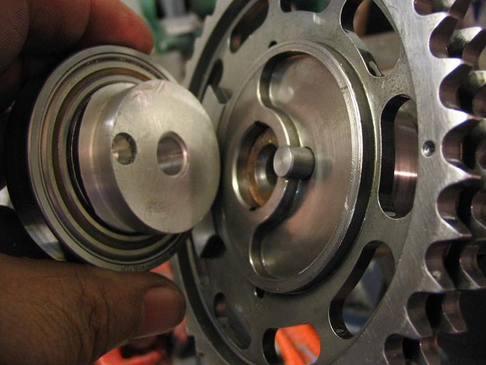

252 area code is here in North Carolina where I live. This bit appears to be some sort of roller bearing cam eccentric. Question is, does it use a index hole or pin like the one on the right? I'm using a mechanical pump myself, and you can read about some of my issues with a cam gear that had no pin.
http://www.gt40s.com/forum/tech-engi...ical+fuel+pump
If this thing bolts on somehow, with no tab or pin, I'm getting one!

Yes Ron it use an index. Fortunately, my engine is dismantled and I do one picture to show the pin. But be careful, this part is not a "bolt on" type. I have spend some time on my lath to adapt it

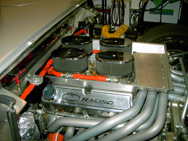

I was hoping my engine build would be done by now. Waiting for the collectors so the exhaust can be completed. Started out as 351W with 30 over and fresh rebuild. He forgot to tell it had been left out in the rain. Everything stripped and sold. Bored 60 over due to pitting, stroked and internally balanced to around 408(don't remember the stroke #s. Topped off with TWM 8 stack, comp cam and AFR 205s. Intake has been port matched to the heads. Should have some #s in about two weeks if no more delays.

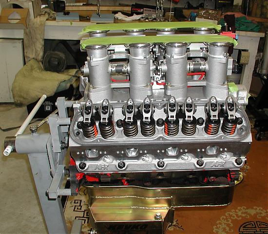

SBF 'Boss 302' stroked to 347ci
TFS Al. heads, competition ported 307cfm
TWM induction/48mm
Accel DFI
Comp custom roller cam (mild 232/236), hydraulic lifters
SRP pistons
Eagle H beam rods
370/370 (RWHP/TQ) at 6500/4800
Actually very similar in spec to Pete's. Pete, what do you get on the dyno?

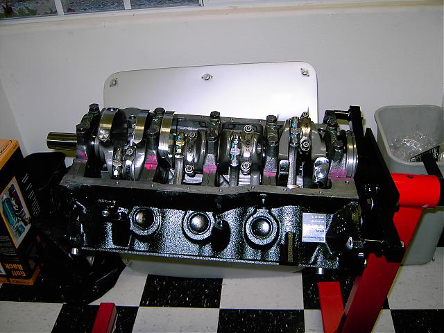

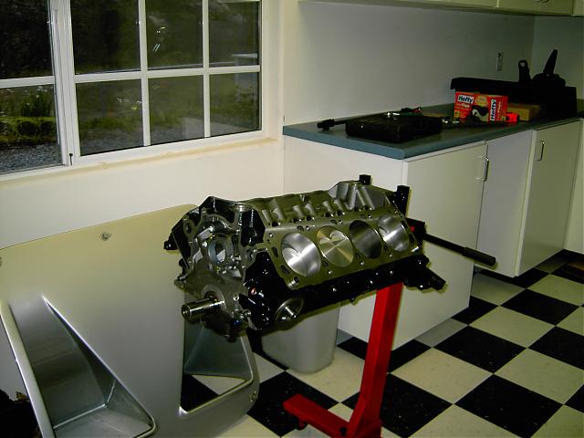

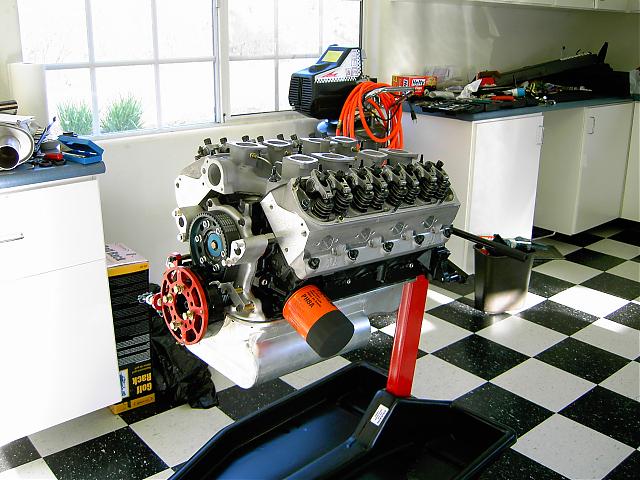

347 SVO shortblock w/ forged crank, rods and pistons, Crower hydraulic roller cam w/ Comp cams steel roller rocker and pushrods, AFR 185 heads w/ 2.02 intakes, 1.60 exhausts, belt drive, Mezier elec water pump, Armando pan, 48 IDF's. digital ignition, Fluidamper, Mcleod 26lb steel flywheel and dual friction clutch, ARP fastners.

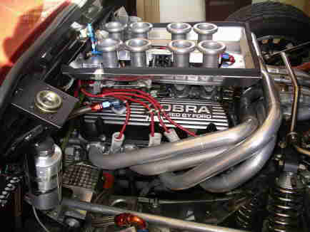

Roush 302 stroker (353) with Roush 8 stack IR injection.

Daryl, really nice looking motor, I'm particularly interested in the stack filters you are using. What make are they?
Cheers, Pete.

I also would like to know about the filters. That is the motor I ALMOST went with...
