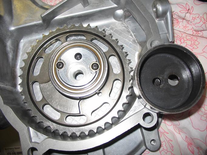

| Re: What Engine Are You Using? Bernard! What is that cool eccentric there on the cam gear??

| Re: What Engine Are You Using? Quote: |
Originally Posted by Ron Earp Bernard! What is that cool eccentric there on the cam gear?? | Hi Ron,
First of them, I have to congatulate you for this forum spirit! It is always a pleasure to read some informations and to see some original pictures (even if I don't write too much  )
As you know, some race engines have to use mechanical fuel pump according to their relevant championship rules. In order to minimise the friction losses between eccentric cam and fuel pump arm, some renowned race part manufacturers (such Jesel or Crower) have provided this original cam design. My job has been to find this part to e-Bay (10$) and to adapt it because they are only provided for timing belt drive systems. Expective gain is peanuts but I love to modify everything
Picture here below shows the original eccentric cam and the modified.
If you want one part like that at fair price, you have to contact Scott Eatmon phone : (252) 237-2437. He is a pleasant race part dealer and you can say that your link is coming from a small french guy |
