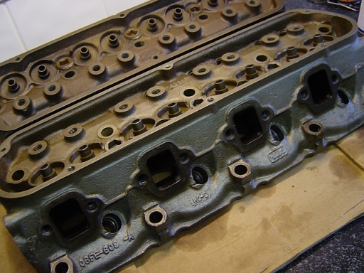

Please advise if you can recommend sources of data or original Ford part numbers to blue print a pair of C6FE heads.
These heads have 1.88"/1.625" valves and were formerly ported by Valley Head Services. Canoga Park, Calif.

Jac Mac,
The part numbers on the castings read C6FE-6090-A, both on the fronts and in the top wells ?
I have considered using HiPo parts (C3OZ series) but would prefer original GT40 racing programme parts if these were ever made for these heads.

James, You must be quoting the numbers cast on the head. The numbers I gave you are the actual Ford p/n if you had to look for them in a Ford Parts Book.
( I have a Ford Muscle Series Books) which I found those from.
Also found a USA web site with further info on some really odd heads, will dig it out and post later.

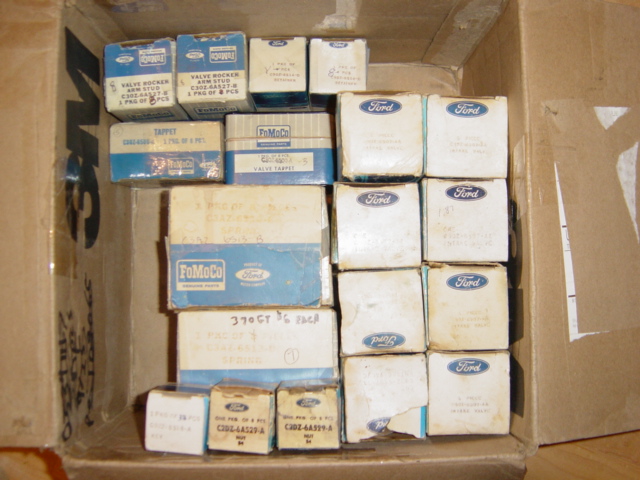

Jac Mac,
Christmas has come early.
I received your complete set of parts today from JD Larson of All Classic Motors, USA. Well recommended.
Many thanks for your help in this.
