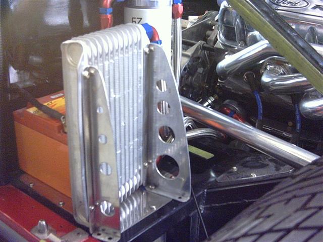

Re: Oil Cooler Advice
I have mounted mine in the rear. Since we have two rear vented areas I decided to use both. One for the oil, and one for the trans. Cleans up the shelf area for other things. Both Mocals with AN 10s. Plumed in an Acusump also for those long "slow" turns.
