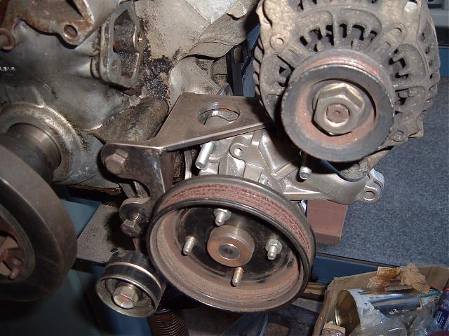

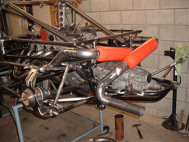

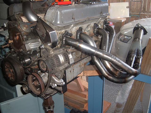

I almost had as much space trouble with the water pump and altenator. The whole system fits in neatly as per the origional out put position after a bit of juggling. There is a flange where I could have put a reducer if `back pressure`was an issue. The chassis is all painted up and assembly is underway with the body also having been fitted and painted.

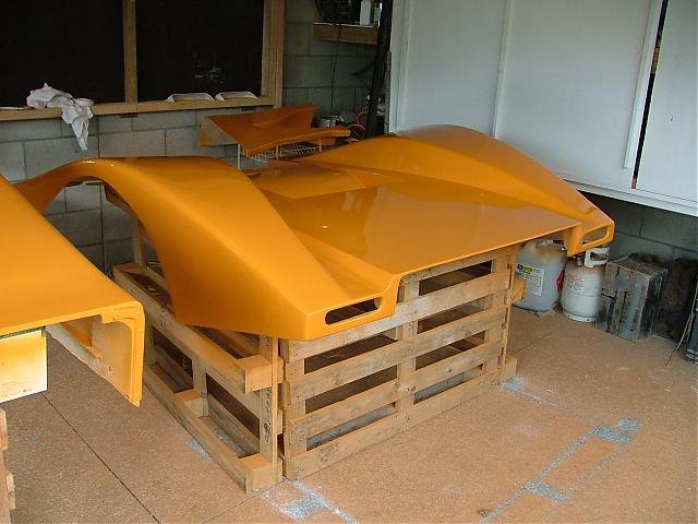

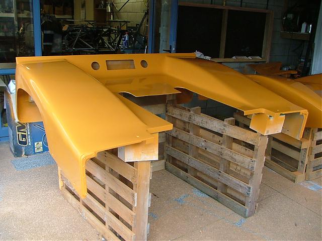

I could not fit the water pump in the the rear space provided as I have built to factory bulkhead spaces. I bought one of those pumps and did not like the thought of trusting such a pisy little thing so went belt driven impeller / mechanical,ex common Nissan. The alt is ex a Diahatsu for size and weight as its not going on the road. All pully`s are ex varied micro groove and the main drive is mounted of the back of the harmonic balancer boss to save length. The oil filter is remote also as the cooler is in the side pod.
