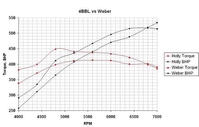

On this data Webers look better...

But you never know all the details on the carb sets, who tuned it and set it up for the motor, so forth and so on. If the owner and builder isn't 100% out to get objective results, and are willing to do 100% of the work needed for both sets of carbs, which might include a cam swap to take advantage of what each has to offer, then it is relatively inconclusive.
My money is on a well-done 4bbl though (with numerous posts on various aspects of them and why I think that). In the states with an abundance of 4bbl knowledge it is relatively easy to get extemely good quality builders and carbs plus knowledge of tuning and running.

I dont disagree with you Ron (about the data).... I just like seeing data like that in a graph...
More specific data would be required from Peruch about cams etc.
I'm hooked into the 48IDA's but you know where I'm coming from ref originality (with a pinch of fiscal prudence).
Whatever the carb/stroke/chassis/trans combo used, deep down it dosent matter to me they are all GT40's....

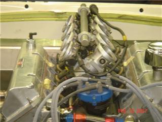

putting this intake from the '99-2001 panoz lmp car onto my 435" yates engine. changing because the 4bbl yates intake plus carb are way too tall and present a "packaging" problem. with carb it was 649hp at 6300. will change to this intake,sans distributor and with autronic ecu and ls-1 coils. will let you know what updated dyno results are when installed and tuned. also have another to put on 8.2 deck all alum engine; maybe for fran's new "p" car?
cheers,
rd
