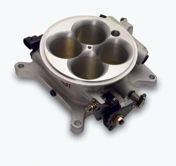

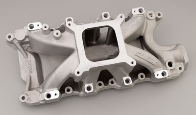

I'm thinking of using a victor junior super EFi manifold and 4 barrel 1200 CFM throttle body on my DRB. Apart from not knowing if it will fit under the hatch, Am I making a big mistake using this set up? and is anyone running one of these manifold with success?
I'm thinking of buying this stuff from Summit racing.com can anyone recomend other web shops to purchase from?

Hi Dave -
I've setup a couple of cars with these on. GTD40 (SB302Ford) and GTD R42 (SB383Chevy). Both ran Motec M48 on sequential injection and gave good results, plus, they have a good idle speed control valve which makes easy idle. Quite low in profile too so if deck room is an issue, they'll help there too.

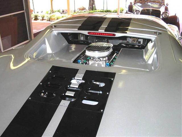

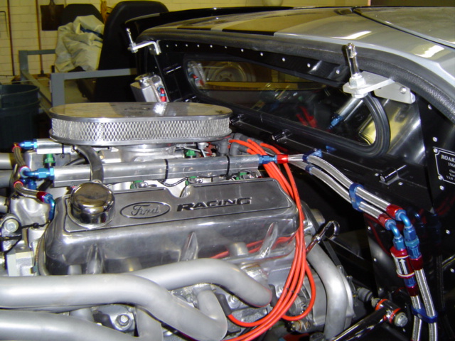

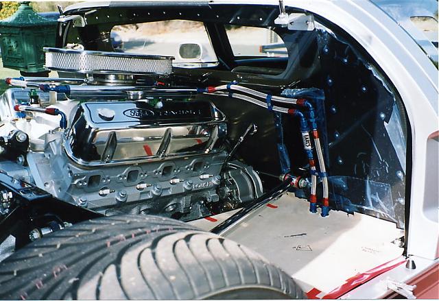

1000cfm throttle body on victor jr manifold. The whole package came from EFI hardware in Melbourne. It was very competetively priced and really good package in operation. In some ways it was preferable over the 8 stack system. It certainly had a higher power output than 8 stacks.
If you haven't called them it is worth the call. The other bonus is that they are at least within Oz so freight and duty wont stack up the costs.
Photo attached of the original setup on my car.
