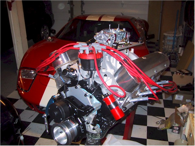

Old 07-01-07, 07:38 PM   #20 (permalink)
Neal's Avatar
Neal
8 Tenths
Location: Seattle, WA, US
GT40: GT40 NZ
Posts: 845
Rep Power: 15 Neal is a glorious beacon of light
Re: Guess my HP / TQ
Say hello to my little friend. Dyno time next week.
