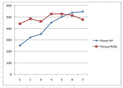

Hello,
I just got the numbers from Roush on my new engine (to go into a SPF GT40 Mk1). It's a 351W - 427IR. All alloy.
RPM Tque HP
3000 441 252
3500 485 323
4000 462 352
4500 527 451
5000 527 502
5500 514 538
6000 478 547
Given the dip in torque around 3800 rpm, there seems to be a huge increase in power between 4 and 4.5k rpm: 350 to 450hp. I guess I'll need a light foot.

Re: Roush dyno test
I was wondering if anyone knew why the torque curve on this engine could be going up and down like that. I'd like to understand why it is the case, but I have no idea where to look. In some older books I had on Ford small blocks, the charts there did not show a substantial difference in torque or power curves between injected / non-injected.
Suggestions and ideas are very welcome!
Laurent

Re: Roush dyno test
Laurent,
Here isthesheet of our 427 aluminum engine which I posted yesterday on the Manufacturers Forum.
The explaination for your slight dip is possibly a function of the relationship between the chosen cam lobe design, the intake port and the header used. In short, a small reversion at that time in the RPM band.
We also sometimes see that in our A/F sensor readings where the mixture goes slightly rich or lean in that timeframe. Tuning your IR system's A/F ratio may improve that "hole".
You can see we experienced a very small richening of A/F between 5100 and 5400 RPM which caused a very minor torque dip. Overall though, for a carburetor, this one is well dialed in.
Good luck in your efforts.

Re: Roush dyno test
Hi Laurent...
Interesting figures, there's a definate dip at about 3K and I can only see difference being caused by changes to fuelling / timing requirements. I wonder if Roush map for each individual motor built, or have a 'generic' map on file that they install for each build type??
I am expecting a similar spec all alloy 427IR in a dry-sumped configuration from them shortly, so it will be interesting to compare the figures they provide with that too.
When we dyno'd Roy's 347 Alloy Clevor - we had a dip at about 4K, that I managed to pretty much dial out by adjusting the fuelling in that range. I presumed it was a function of the runner capacity/flow characteristics that seemed to improve the airflow at that rpm. If I recall correctly, we added additional fuel as it was a tad lean either side.
I'm not sure whether the Roush provided map is 'locked' either, hopefully not, although I suspect it will be for 'warranty purposes'... Talking of which, what is your intended use for the motor and what warranty terms do you have??
Your dyno results plotted in Excel.

Re: Roush dyno test
Thanks a lot for these replies. I understand better what is going on. Manowar, these are very nice engines you put together, I remember reading an article - I think maybe in Kitcar magazine. I see the slight dip you have in torque around 5k rpm, it is really minor.
I have posted the dyno sheet, and put it in Excel as well. P Thompson, sorry you ended up typing it in, I had this spreadsheet already but had not figured out how I could attach documents!
In any case I will definitely ask Roush if they can smooth out the curve a bit.
