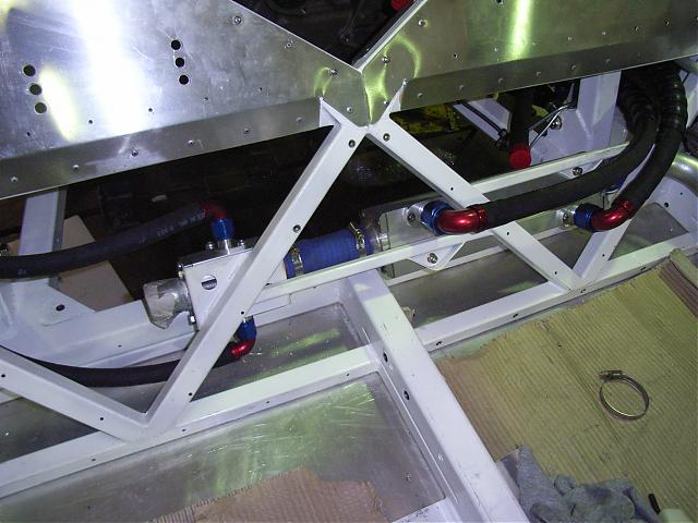

Has anybody had experience with heat exchange units ? We have installed one for the engine and one for the gearbox, they look way too small for my untrained eye but I am assured they are capable of firstly bringing the engine and gearbox up to temperature quickly, then maintaining them both at optimum temperature.

Re: oil filter / cooler plumbing
Iain,
There's quite a bit of discussion on this thread :-
Combined rad/oil cooler
Scratchbuilt Gulf Mk1, forged, dry sumped 351W. 930 LSD & spraybar, 10s & 14s. Slowly getting there
http://www.gt40s.com/forum/gt40-buil...atchbuilt.html
Russ Noble is offline
Old 10-01-07, 06:21 AM   #9 (permalink)
jac mac's Avatar
jac mac
New Zealand
Join Date: Dec 2005
Location: Gore N.Z.
Posts: 1,761
Rep Power: 23 jac mac has much to be proud ofjac mac has much to be proud of
Smile Re: oil filter / cooler plumbing
Ian,
We run one on the TVR ( SBF ), approx 300mm long, 75mm dia. Installs in lower radiator hose, coolant thru center, lube around core tube, built it myself in a fit of anger after two high $$$ crap quality conventional air/oil coolers had failed in succession with small leaks in core. Oil temp without was heading for 270°+ ,now around 210°/ 220° constant.
