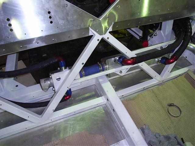

Has anybody had experience with heat exchange units ? We have installed one for the engine and one for the gearbox, they look way too small for my untrained eye but I am assured they are capable of firstly bringing the engine and gearbox up to temperature quickly, then maintaining them both at optimum temperature.

Ian,
We run one on the TVR ( SBF ), approx 300mm long, 75mm dia. Installs in lower radiator hose, coolant thru center, lube around core tube, built it myself in a fit of anger after two high $$$ crap quality conventional air/oil coolers had failed in succession with small leaks in core. Oil temp without was heading for 270°+ ,now around 210°/ 220° constant.
