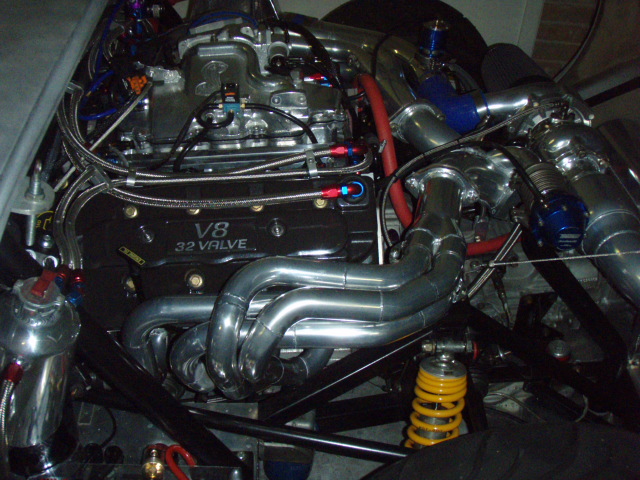

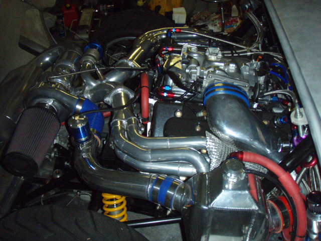

Bill: The transaxle is the 01E six speed with Quaife diff. I run 315/30 street slicks on 18" x 12" rims. I've driven it hard on 15psi on the road and the box is solid. I know that it's a lot of power and it will surely test any box. So far the tires have given way first.
Ali: I'm running the Haltech E11V2 ecu together with a M&W CDI unit. I had an EMS 8860 in it to start with, but struggled to pass emmisions with it, so we went for the Haltech. The lovely men at the RTA made me go down to half of 79/01 emmissions before they gave me a pass. How nice is that?
Here's a couple of shots.
