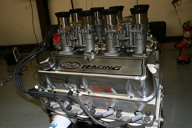

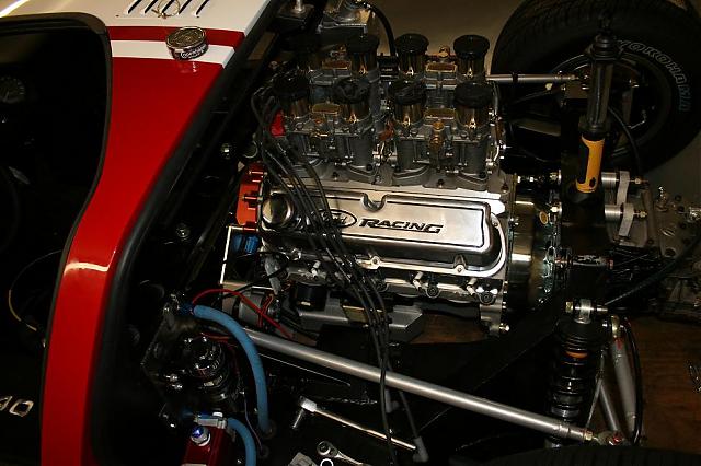

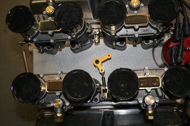

I just got my motor a couple weeks ago, for months the engine builder was been waiting on IDA webers. The engine is Dart block 427 with 9.5 deck height. I have it in the car with transaxle bolted up just to get all the plumbing done. My buddy shows up and we decide to put the read deck lid on, we found the deck lid has been fabricated with the area for the carbs off to one side by 1.25 inch. Its a SPF Mk1 and the area where the carbs protrude up through the deck hit one side. I am not wanting to take a saw to the deck so we started with options. Looks like with the added hight I have a problem manufacturing some kind of air-cleaner also. Down the road I was going to convert to EFI throttle bodies so that is what is going to happen. My question is what is the whole system worth together or should I sell carbs and manifold and distributor separate? What are brand new 48 IDA's worth with a box of jets? The manifold is windsor block manifold with spacers for the added deck height, the distributor has an extension on it for the higher manifold. I am willing to trade for EFI and Cleveland manifold for someone who doesn't like EFI. Idea's opinions welcome.

That's a drag Jack. Especially with a chassis the price tag of yours. Did you contact SPF?
Regarding reselling, my opinion would be to list them as a complete assembly. New price is right about $3K, so something a little less than that for a new unused would seem appropriate.

Seems strange to be 'offset', how are other SPF owners dealing with this?
Originally Posted by P2164 View Post
....The manifold is windsor block manifold with spacers for the added deck height, the distributor has an extension on it for the higher manifold. I am willing to trade for EFI and Cleveland manifold for someone who doesn't like EFI.
You have a Dart 9.5" deck height and the 351W is 9.5" too, why the need for spacers or are you saying the manifold is for a 8.2" deck 302?
The Cleveland is a 9.2" deck height are you sure that's what you need? Hall Pantera sells Cleveland manifolds; make sure you get the correct one for std port heads or raised port. They run about ~$650. Kelly Colefield sells complete EFI systems bolted on his own IR manifold casting, not cheap but excellent quality. Dennis Quella at Pantera Peformance, CO also has a nice EFI set up.
As you already have a manifold bolted to the engine why not consider using that as a basis for your EFI and selling the bare 48IDA's carbs?
Yep thats the case, I also have the new MSD distributor and extention for the extra hight of the manifold along with a MSA 6 unit, I would like to sell package just for the ease of it but more than likely will have to sell individually. I have no idea what the issue is with SPF, I will call Dennis and ask. I don't want to cut the deck lid I know that. With EFI it will all fit as the throttle bodies are shorter and the fuel rail is on the inside rather than run on the outside like the carbs. Thanks for the info and send someone my way if you know of anyone.

It looks like the way your linkage is set up, the shaft of the right-rear carb is going to take the torque load of operating both carbs in the left side. I was told it's better to place the link that connects the right and left bank in the center, rather the rear, so that there isn't any twisting of the shafts. But this may be outdated thinking - it was back in the '70s.

Your absolutely correct, I was going to change that but now someone else can make it the way they want. That was the first thing I seen and didn't like when I got the motor.
