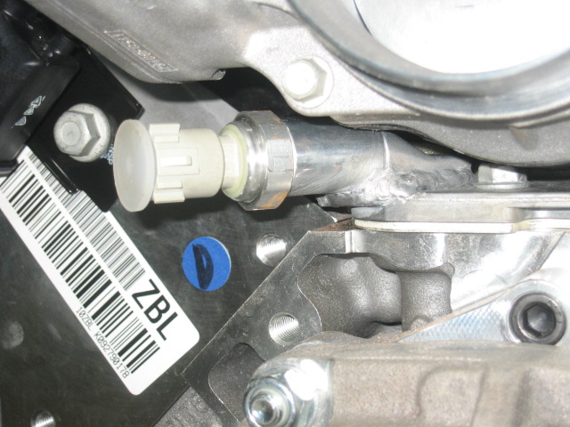

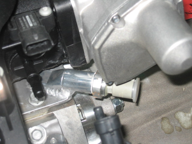

This is what I did.
ID:	47822   Click image for larger version

Katech has a modified valley cover, and an aluminum adaptor that allows the use of most any sensor. You can see them at: Search Results -- Katech Performance Online Store
It is specifically designed for Gen4 engines with a reversed intake.

I cut mine down, welded it up, drilled and tapped it to a 1/8" NPT, then installed an AN fitting to use for a mechanical pressure gauge on the dash.

I used the Katech valley cover and it fits great as Will points out.
