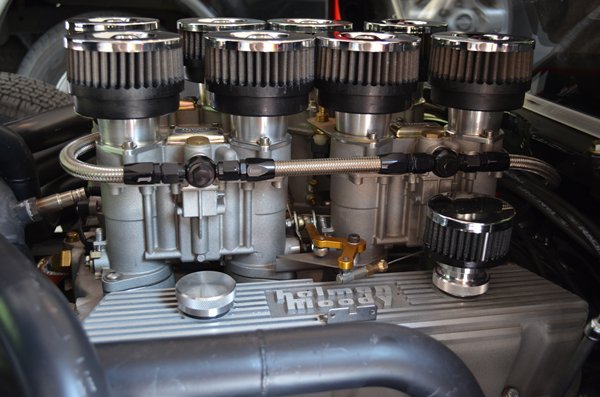

I've had my Eight Stack system for about a year now and it's very good. I like the vintage look of the system, and the company is great to work with. www.eightstack.com
Name:	Eight Stack.jpg

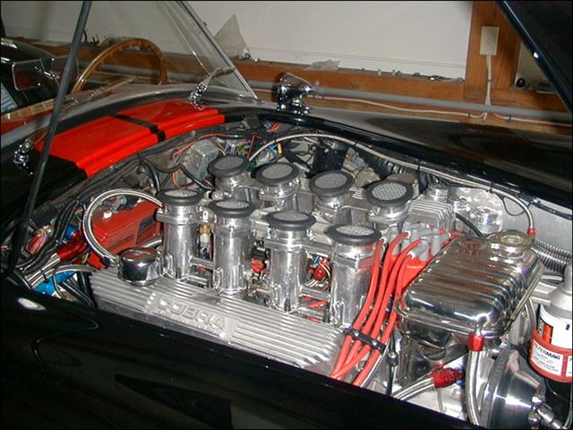

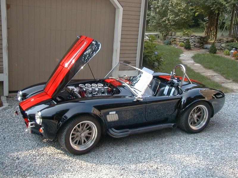

I had a TWM setup on a 496" 427SO Cobra I sold. Great looking and performing!
ID:	59089   Click image for larger version
Name:	wohlstrom1 (Small).jpg
