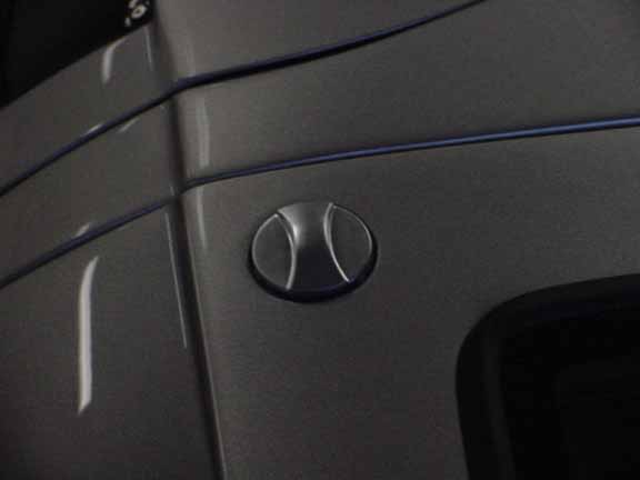

I am also using Dzus, but for the rear clip, I stole a styling queue from Hershal. I have put two 1969 Cobra Hood hold downs, counter sunk so as to be flush with the surface on either side of the top of the rear clip. These are basically giant dzus 1/4 turn fasteners with nice finger grasp tops. Thanks for the idea Hersh, I love them!
Lynn

Could you or Hershal post a picture of these latches to give the rest of us an idea of how they are placed. Forgive me if they are already posted on this forum but I can't seem to find any.

Here ya" go Rolf.
Mine are 68 Shelby Mustang hood pins and I got them from
Tony Branda.
