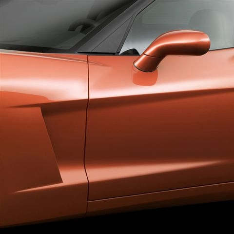

Has anyone considered the mirrors from the new C6 Corvette or the older C5.
