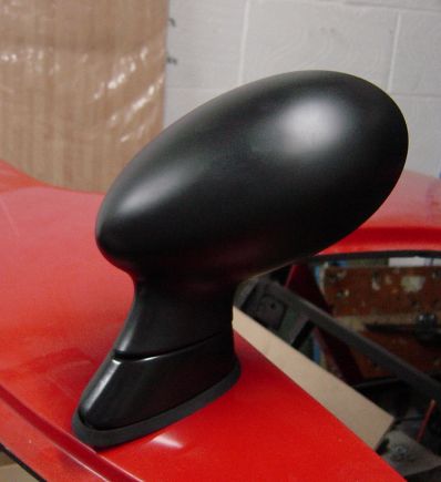

Re: Door mirrors
There was set on eBay the other week going for £170
Have you also maybe considered one of these?

Re: Door mirrors
which is a BMW M Coupe mirror, NOT a Mini. If you notice theere is a slightly more 'muscular' point at the front to use a nice motor buzz word. Here's another view.

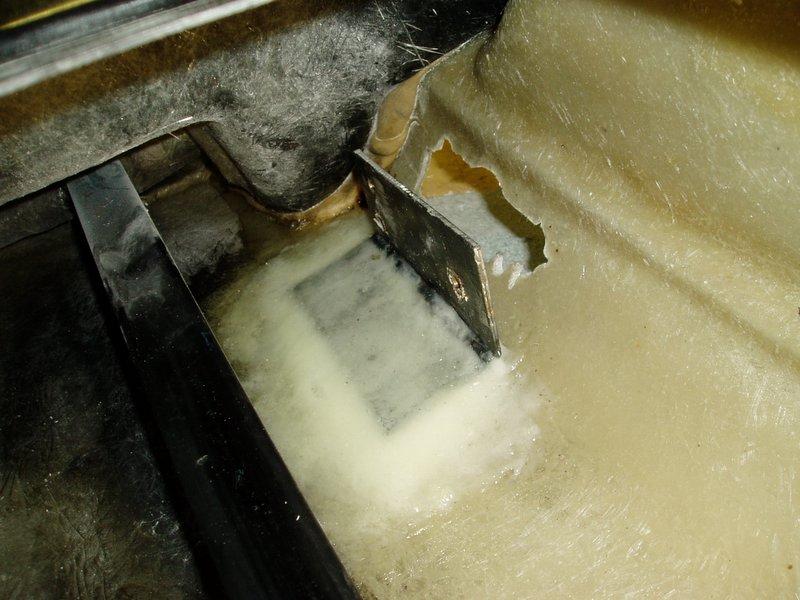

Hi Brian
Re the mirrors on Roy's GTD - we cut a hole in the door large enough for the mirror's cabling/protrusion to fit through and fibreglassed a suitable metal support inside to bolt it to.
To enable the mirror to fit the curve of the door, the rubber gasket between mirror base and door was removed and the mirror mount (Plastic) carefully trimmed with a sharp knife to match (ish) the profile of the door. Rubber seal was refitted to give a tidy finish. Be careful with the trimming as you need to retain the correct angle for viewing and obviously need to get both sides similiar. Make sure you sit in the car whilst someone holds the mirror to the door and then get them in the car and you hold the mirror to the door. This better enables you to visualize exactly where the mirror needs to be fitted.
Finally, do the above with the car on its wheels on the ground, with the rear deck on!, else you may not be able to correctly evaluate exactly what can and cannot be seen in the mirrors. Plus - remember they only adjust 'so far', so ensure you are not at the limit of adjustment when you test. You might want to allow for other drivers of different height (seat position?) to drive so allow for that too - after all, if they are electrically adjustable they should be 'usefully adjustable' - hope this helps...
If you get stuck, I can photograph the inside of Roys door next time I'm over there.

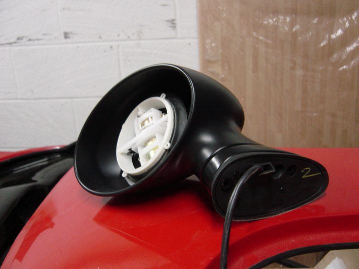

HI Paul,
I would like those pictures of the inside mountings of Roys mirrors.
Also if anyone has pictures of the gubbins insdie the electric mirrors I would like to see that to see if it can be retrofitted to other mirrors.

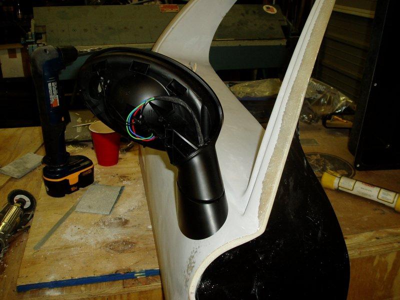

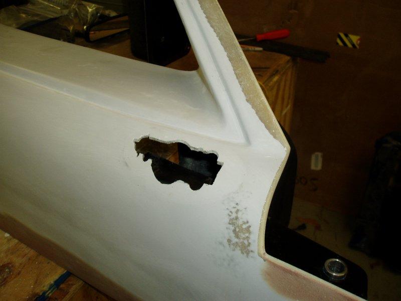

Hi Dave, I purchased new Mini mirrors on ebay for $90 each. I wired a saab 900(96) switch which required no modifications (relays). I hope these photos help.

2

3

Wow thats a intricate hole you had to cut Jim, good job .Nice mirrors [img]/ubbthreads/images/graemlins/driving.gif[/img]

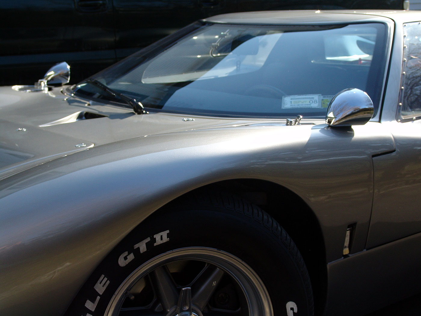

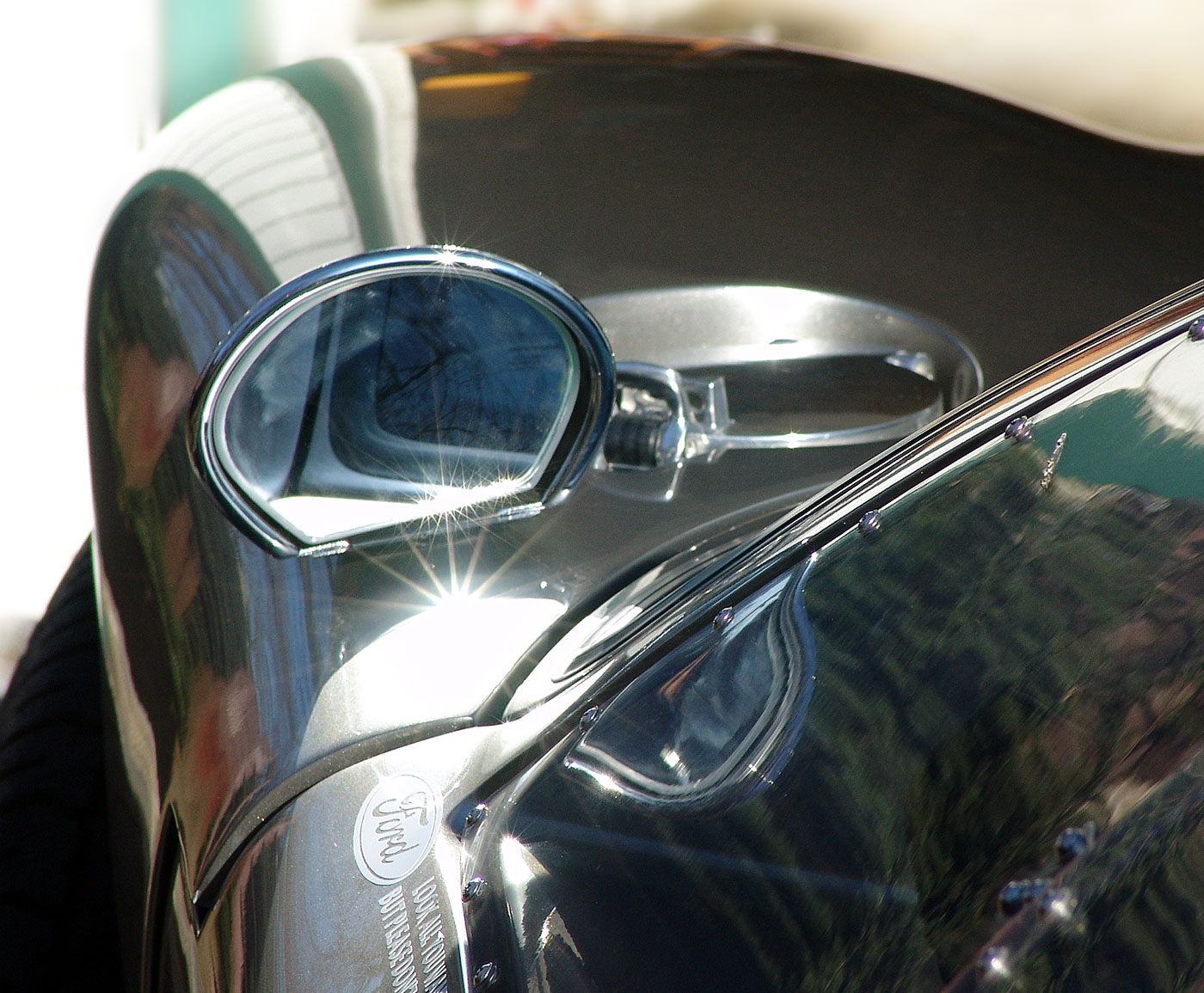

I just got a pair of Vitaloni Sebrings in Chrome on EBay for $120.

GT40: CAVMONO29
Posts: 242
Rep Power: 5 JCoop will become famous soon enough
Re: Door mirrors
another shot, closer...

Re: Door mirrors
Ray,
This is exactly same mirrors I bought few week ago at one of the shops in Tokyo w/ bit more $$$. Havn't fitted yet to my GTD. Even minor degradation on visibility compare to other mirrors, I'd prefer this design. Good choice!

Re: Door mirrors
Yuji. when you fit the passenger side mirror, (I guess that's the left side for you over there), cheat a little bit and cock it about 2mm towards the driver. You wil hardly notice the difference; or maybe do it to both. My install works fine but I could have used another 1/4" adjustment to the passenger side. Right now, I see the critical blind spot perfectly but don't see the rear fender at all.
