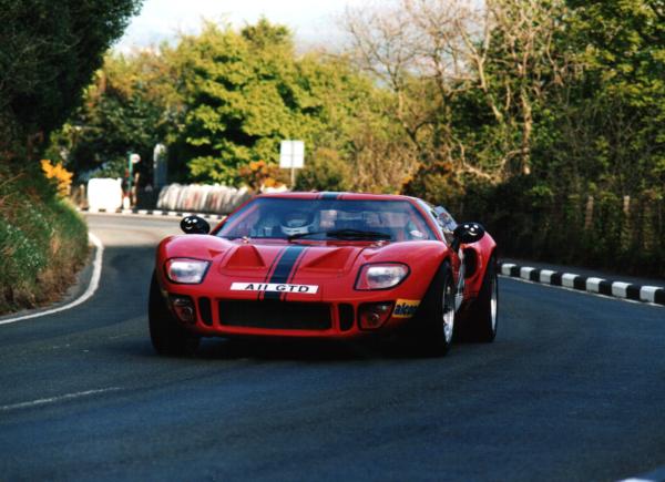

and there you have it - BMW Mini mirrors on Roy Smarts Mk1 GTD - (electrically adjustable + Heated demist!)

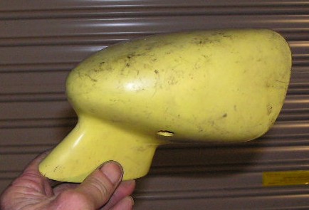

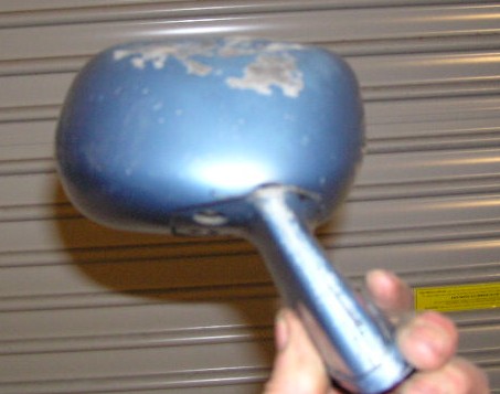

Oz Escort MkI 160 wide 100 high (body dim) base angle 45 deg. All plastic, separate adaptors available for diff slope.

Re: Door mirrors
another view

Re: Door mirrors
and another

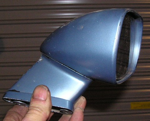

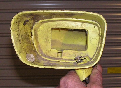

Mazda RX7 Ser I, 160 wide 90 high, plastic body, metal pedestal in 2 parts, 30 deg base angle, elec adj.

Re: Door mirrors
#2
