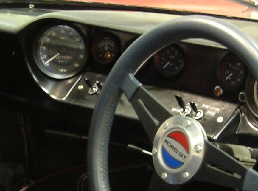

These are basically the ones but they should have black bezels and the 200 mph speedo read mph not km/h.
For final authenticity you can have red 'condoms' over the internal bulbs for the red lighting. This helps to avoid hitting cows on the Mulsanne straight!
Picture attached of 1089 one of the last.

THAT is the picture I've been searching for - a closeup of an original. I like the look of the white pointers and black bezels.
