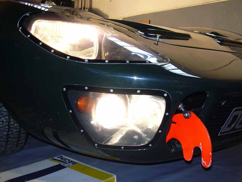

I had a chance to view Sfair chaiis #1137 yesterday.
The lexan covers were all held in place by nylon screws with holes tapped right into the fiberglass.
Is this typical? The windows were also sealed with black RTV.
This seems to work well as the car has been drived VERY hard at numerous track events over the past few years with no problems.
What other methods are there for attachment?

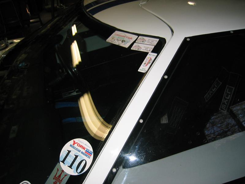

Another

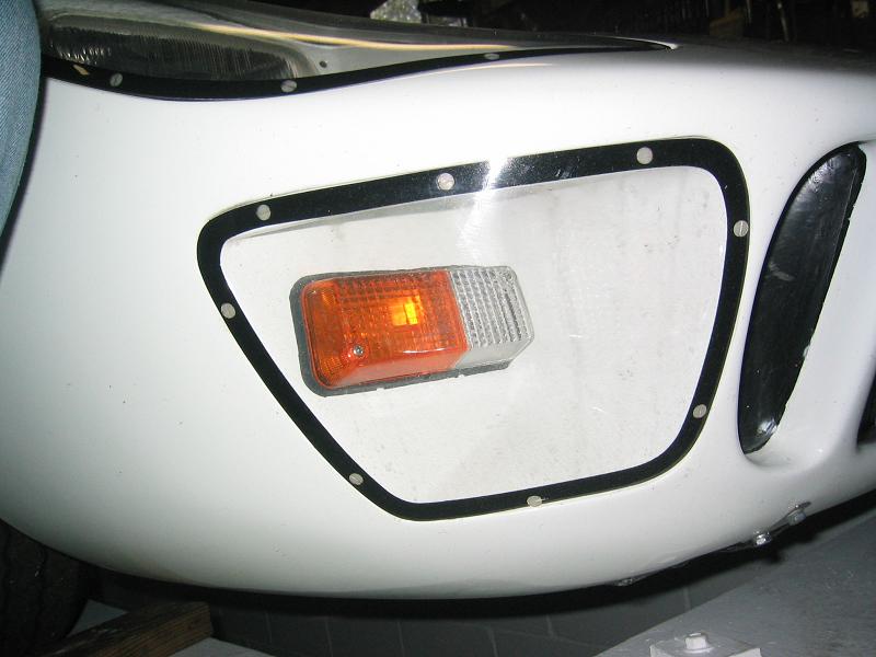

Bill, The border is in fact painted on the reverse side of the plastic. The plastic screws are countersunk into the plastic. On the headlamp and driving lamp covers there is a non adhesive gasket material but the driver and passenger windows are held in with black silicone / rtv? Adams McAll had a safir in their workshop which was damaged at the N-ring and Kerry Adams allowed me to borrow the door to see how Safir had finished it off. I got a few photos at the time and went ahead and did mine the same. The plastic screws are probably 2mm x 20mm c/s (I've still got some left over) so I'll dig them out and be more specific next week. I was directed to a screw retailer in Farnborough here in England to buy them, but I guess they are available almost anywhere.

Safir P1116 did not have the side perspex glued in with RTV. The black border is painted or screened onto the inboard side but all of the plexi/Lexan/perspex pieces were held in with the countersunk nylon screws (I know as I removed several pieces to clean ad detail.) The windscreen IS held in with an RTV type adheasive.

1137 had the front windscreen glued in with something stiffer than RTV.(butyl maybe) The head and fog light covers were NOT glued and fastened with nylon screws.
The side and reat windows are sealed with black RTV and fastened with the same nylon screws.

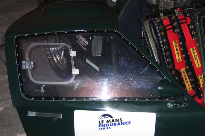

I found that with sufficient screw intervals and a backing gasket the lexan (or what ever it is) did not have a tendancy to wrinkl or warp. Mine came out like this:

The drivers door ( we drive on the correct side.....)
