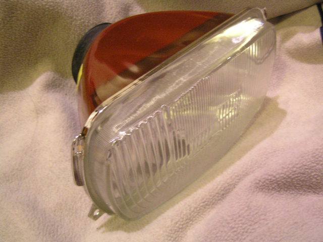

Gents
I am using these lamps...hard to find with the convex radius, but I have them now. They use a P45T lamp, not available here in the U.S.. I am looking at some now with a concave lens that use an H-4 lamp, which I believe is available in both Europe and the U.S.. My lamps are Cibie units which came in a Valeo carton, but I have been unable to locate these on the internet even with the part number.
Name:	Jan 2005 056.jpg
Phil is offline

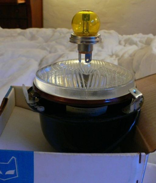

Re: different headlights
BillD -
No info on pricing, and I think they are in Taiwan, so no easy way to get them.
I was looking for the non-halogen versions like below so I can have a couple of spares for the Simca 1000 lights that I got. They came with a couple that were hidden in the boxes.
The round bulbs in the head lamps give them an cool looking yellow glow even when the bulb is off.
I have seen them on Ebay, I think about $25 for the pair so likely they are about $5 each somewhere.
Sandy
