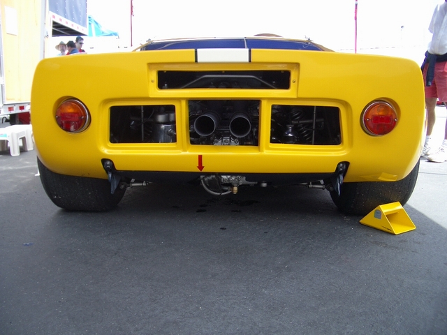

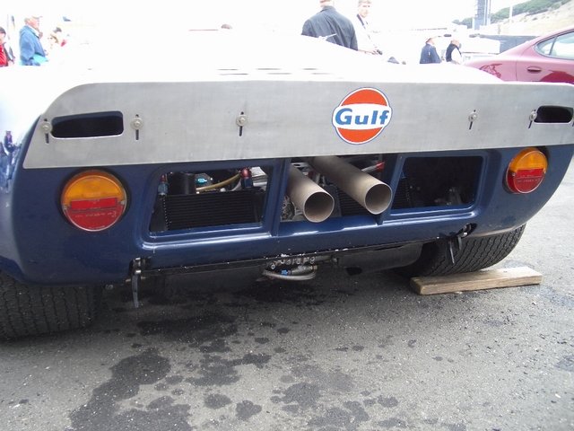

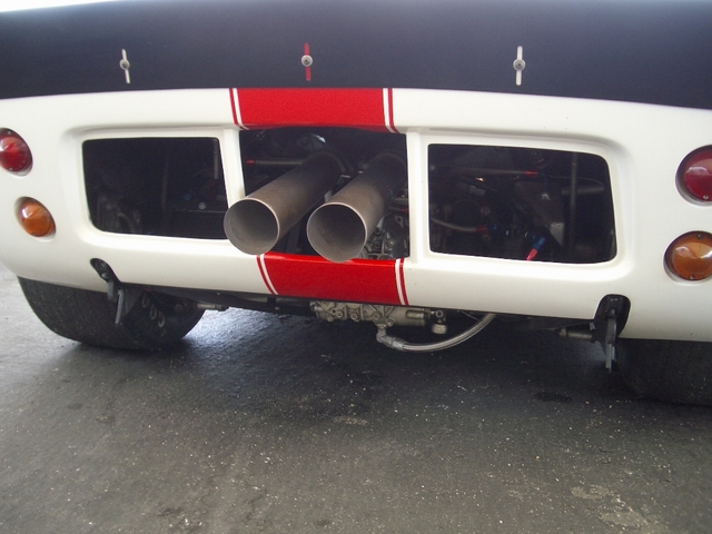

Here are a few close up rear end pictures of cars with 2 and 4 tail lights. Here is a 4 tail light picture of GT40P/1043 with the same lights. The picture you linked to is GT40P/1045. Just a few numbers later is GT40P/1051 now with 2 lights. However I believe 1051 was changed to the 2 light rear clip with flares. The last picture is GT40P/1077 with 2 lights. My picture collection has the same bias; it looks like pictures with a ¾ front view of the car are more common.

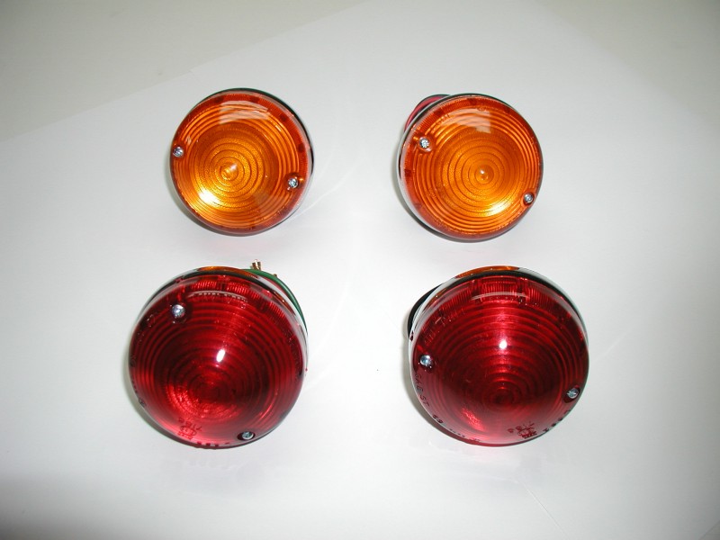

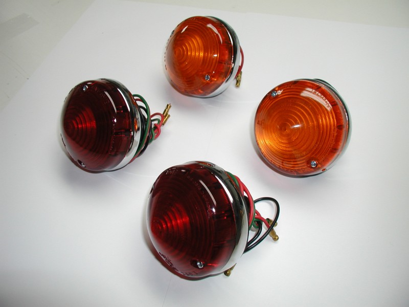

I am in the middle of converting to the earlier version, the lights are Lucas L691 indicator lamp L691 stop/tail lamps from AES UK Ltd. should you need a part number.

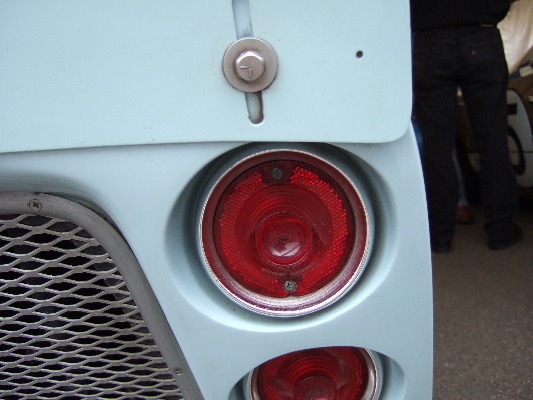

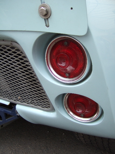

I took some close up pics of a MK2 at Le Mans Classic 2006 re the rear lights - they do not look like the ones above

the Mk.IIs are a bit odd in the whole GT40 pantheon. They were built up in the USA rather than at Slough in the UK so tend to be fitted with American sourced parts.
The rear lights on the Mk.II (and the Mk.IV as far as I know) are from a 1960/61 Chevy Corvair (no idea why they used GM parts http://www.gt40s.com/forum/images/smilies/confused.gif
