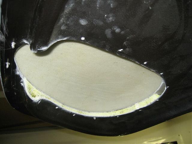

Hi guys. I'm looking for ideas and experiences with finishing the interior half of a Gurney bubble. Since mine is a street car, I can;t really leave it in its current configuration - see pictures.
I opted to fasten it to the roof with (6-32) screws, because I like that look on the original cars and because I didn't want to fiberglass it in. I'm thinking about releiving the inside fiberglass a bit for a little more head room and glassing over the gap between the inside and outside roof panel. Before I can glass that gap in, ouf course, I'll neet to fasten #6 nut - probably epoxy them to the bottom side of the outer roof panel but I'm open to alternative ideas.
The underside of the bubble is flat? What's the point of that?

Ben, the underside has a very small taper and isn't flat. I haven't measured but I believe it allows a full 2" of additional headroom, which is more than I needed. I'm only 6' 0" tall, but have the torso of someone who is 6'4". My head barey touches the ceiling when I sit in the car, but without the bubble I would have to slump in the seat if I were wearing a helmet.
Jimmy, I think 4-5" relief of the inside panel might be a bit too much - I'm thinking something like 1.5-2". But it would be nice to see how other folks have done it. Yes, I have eyebrows also and intend to fit them.
Brian, you can see where I injected the expandable foam in the second picture - I drilled a 7/64" hole in the edge of the door and injected a bunch of Dow "Great Stuff" expandable, flexible foam sealant (I used the Door and Window variety). As you can see, the foam didn't fill the entire door cavity, and I need to get another couple cans of that goop. I'm also running it inside the spider cavity.
I guess a permanant seal with 3M 5200 or epoxy would make sense, since I can't think of any reason I'd need to remove the bubble after the car is finished.

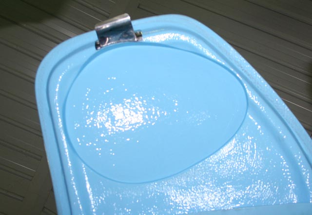

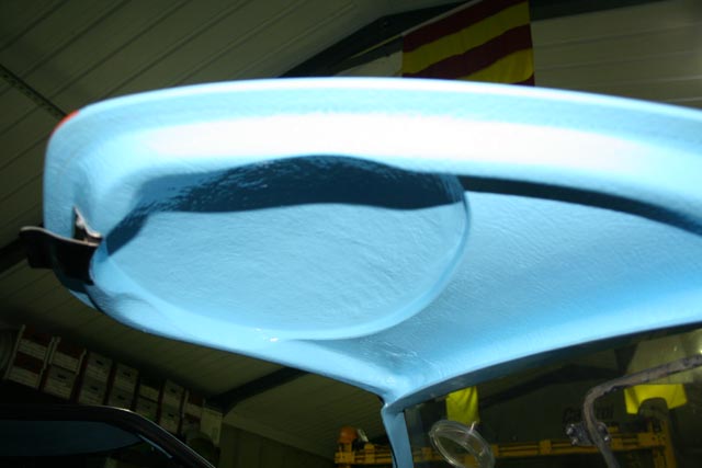

I have just put a gurney into my car. I attach some pictures but I suspect they won't be as helpful as you would like because I glassed mine in. Well I didn't, Lee Dawson did. He did a great job and I highly recommend him.
A couple of comments, I think you might to look at the strength of the door top as you seem to have chopped out part of the inner moulding that I would expect to have given strength to prevent flexing. If you are to glass in that bit, can you glass in some ali or stainless reinformcment to replace the lost bracing? Your bubble seems quite far back on the door top.
The bubbles are tear shaped so is there a "right" way and a "wrong" way to fit them? I don't know, I left that to Lee to do as he saw fit. He had the original GTD template to help though.
I have used mine both with and without helmet. It made a big difference in head room and I no longer have to scrunch down with a helmet on. Huge improvement. I am only 6ft.
I would have put in eyebrows but no one seems to have metal eyebrows on the shelf. Plastic ones yes, metal no. There is a market there for someone....
I think Ron's idea of screw heads on top but glassed in in reality is the best solution. How often do you expect to remove this bubble? Maybe on a sunny day? My concern is having exposed metal projections into the cabin. Generally sitting in the car you may miss them but if you have a "moment" or worse, you could do yourself some serious damage!

Mark, beware of lift at moderate speeds. I use a tongue to hold my door top down. You can see it in the pictures. If I removed it and ran say at 70 down the road, I would expect the door top to try and lift up. If you put eyebrows in as I think you are then that should reduce this concern.
An equivalent problem for some was the double vent nostril panels. You need to have a tongue on those at the windscreen edge to prevent lift due to higher pressures under the front clip. When you are lapping a circuit at a decent speed you could see 1 inch of air where the panel had lifted up! Big single vent nostrils (deep throats) don't suffer this build up of pressure in quite the same way. However cabin air pressure can build up if you have a double nostril panel. I used to get it and when I opened the little window, I could feel the release of pressure in my ears and sometimes even hear it! This pressure would push up on the door top.
