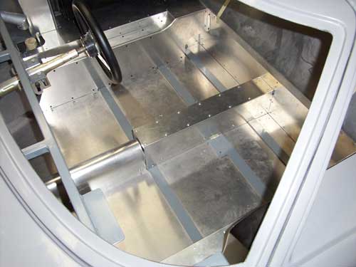

It's not the material it's the design application. Think about it. Almost the entire load bearing structure of a 747 jet is.... get ready.... aluminum.
My GT40 has a .083" 7075-T7 aluminum floorpan. That's less than 3/32" thick. The seats are bolted directly to the floorpan. You guys are afraid of 1/8" aluminum?, you're over reacting.
Mounting directly to an aluminum floorpan is perfectly safe as long as you have a large hardened backup washer on the outside underneath. All this does is distribute the load enough so it's physically impossible for the washer/bolt to pull through under any foreseeable crash loading.
Don't believe me? Let's calculate. Seats bolted in with 4 count 5/16" grade 8 bolts, with hardened 2"OD back up washers, with an 1/8" 6061 T6 aluminum floor pan. Take the weight of the seat, then double it to accommodate loading from the occupant (restrained by the belts), accelerate to 100mph and do a dead stop. I'll guarantee the seat will NEVER pull through the pan. The main reason being it's never loaded that much in the pull direction. The belts are anchored to the chassis, the most loading on the seat occurs when the occupant slams back down or is hit from the rear and that's in the other direction.
You could have a big washer on the inside also, I don't because the sliders are large enough there's no way they could punch through the floor from the inside.
