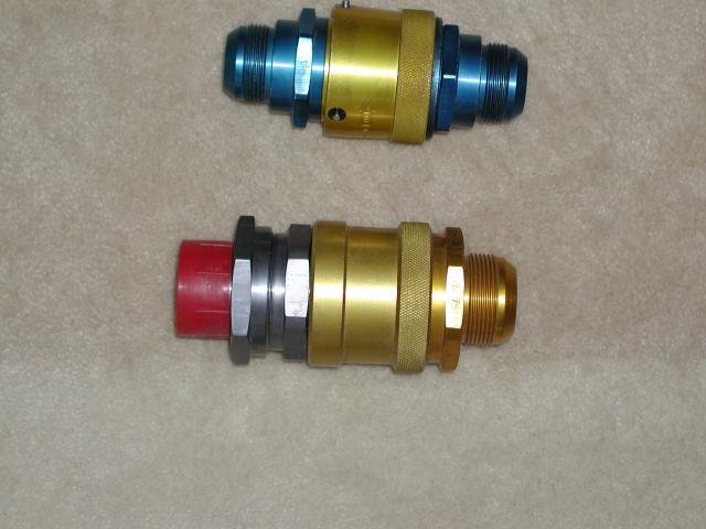

I got to thinking about what you want to do. I hit on a problem for you t think about. With a line as big as you want you are going to have a lot of fuel movement in both directions!! You will need a one way valve with little or no resistance to flow. These are not cheap in the AN8 variety. I think you will find out that in a significant left hander(assuming your pickup is on the right side) your fuel will flow in the wrong direction rather quickly. This could cause the pump to starve, and might cause premature failure. I think you will find it will play havoc with the fuel level gauge as well.
Lotus has the same idea with a crossover. They use a small one that takes a little time to get any significant volume over to the other side. When filling only one side to the fill cut off, will show a lower volume than full on the gauge once settled.
I am considering an 8AN line. I also want to incorporate a quick connect in the crossover line in case maintenance is required on say the sender.
BTW I have one of those in 20 and 24 as well!!!

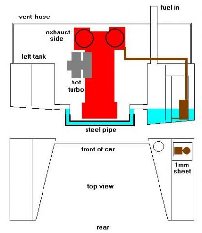

Bill, I will do hardly any trackday's so a fast left or right corner will only happen on the autobahn yes yes the autobahn only 100miles away (1,5 hrs) if I am going to do a track day I must fill up properly
Jim, "rick your making life hard for yourself" yes I know I have build the chassis/suspention myself (lol) emailed samco and the told me today that ther hose is not up to this job (even the fuel resistance) verry nice people to tell the true to a customer, i like that for a change
Mike I live in holland aka the netherlands, if you think of flat multiply by two and thats where I live haha no hill's or mountens. but I have a simple swirl pot inside the tank
speedquest yeh lotus.... lots of tro...oops well you know...(me too) demon does not sell bended fuel hose (I have been there last week) but I have a good hose but not with the bend in it

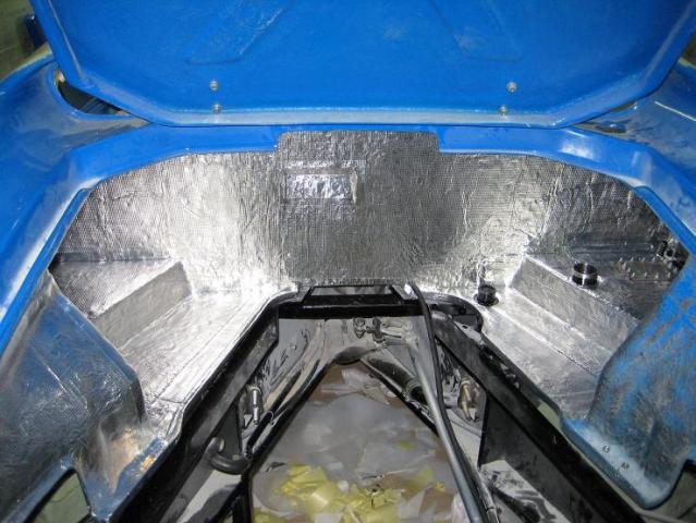

Name:	fuel tank overview.jpg
ID:	39190   Click image for larger version
