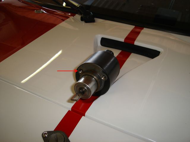

I had his problem recently on my CAV solenoid and it turned out to be internal corrosion on the terminals. I removed it and sprayed WD40 in through the starter to solenoid screw holes and after a few clicks it came right and has been ok since. The securing screws have sealant on the taper which wears off allowing moisture to seep in.

Hi Tony,Ford starter motors are easy to dismantle and rather easy to assemble.But a Ford usa starter does not have a starter solenoid.The drive gear is put forward by one pole from the magnetic field which clics into the starter when it receives power.crude but it works.greetings Emiel
