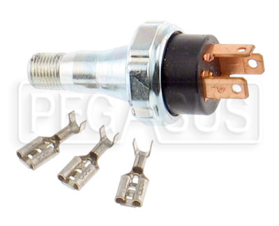

If you want to add some real safety, add a low pressure cutout switch like the one below. Most of the speed shops have them. It essentially cuts power to the fuel pump or ECU(your choice) when a preset pressure is met. They are anywhere from about 7 psi to 12. The third lead can go to a low pressure light for warning. This could be added in series to an inertia switch. A bypass button can be added to do just that for cranking. It also add a safety feature, in that if someone doesn't know about it, they can't crank it. Read steal it.
