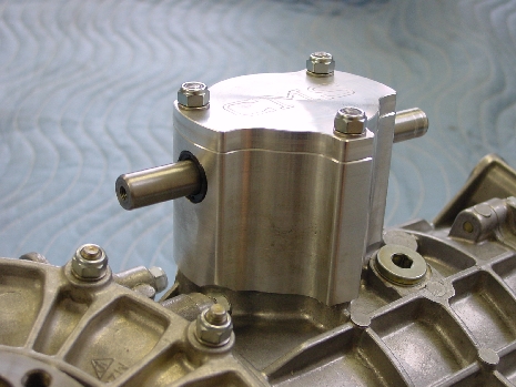

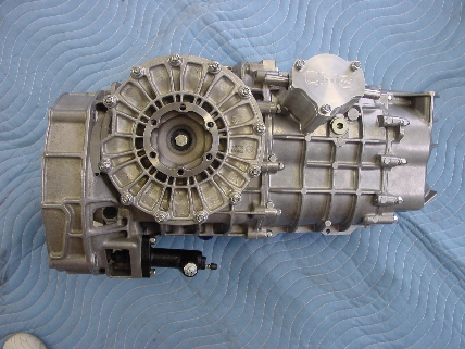

G50-52, side shift, G50-50 bell housing, ring gear oiler & shorten nose piece:

& close up:

Wow, all this time I thought I was stupid for cutting a hole in the side of my tranny, my side shift setup is almost identical to that, who sells it and how much?? Like to know if I bother finishing mine or not.
Eric is offline

Tim,
Come on, don't keep us in suspense! Where did you find this jewel and where can we get more info, PLEASE!
Are the initials CMS or GMS ??
Lynn

Sorry guys, forgot to get back to you [img]/ubbthreads/images/graemlins/crazy.gif[/img]
It's stamped "CMS". That's all I know.
Bobby Hart at California Motorsports in Lake Havasu City, AZ did the complete rebuild on the G50 and that is the shift unit he attached. For more info he would be happy to fill you in, very nice guy. It may even be proprietary, I don't know.
Bobby can be reached at: 928-855-5755 (no web-site avail)
