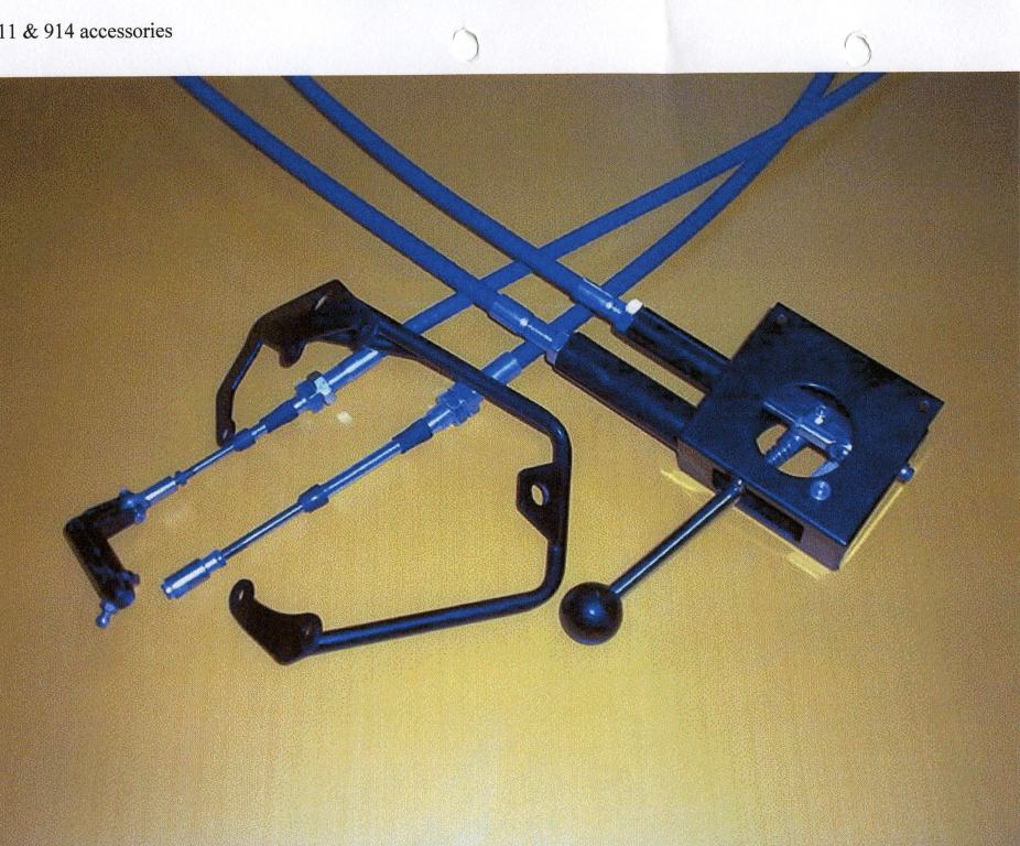

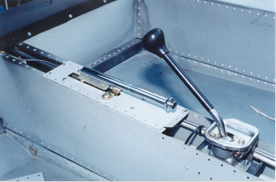

I was speaking with Renegade a couple of weeks ago. They have changed their cable system recently from the one supplied also by Patrick and Powerhouse II to a different one which connects to the side shifter Lynn mentioned. They no longer supply the one supplied by Patrick and Powerhouse II which connects to the rear rod. Here is a picture of the new one supplied by Renegade.

Here is a picture of the one supplied by Patrick and Powerhouse II. This picture is a couple of years old, so it may have been developed since then. This is the one for 930 normal (Porsche) way up. They also do a very similar one for G50 inverted. I don't have any photos of it. If anyone has please can you send me them.

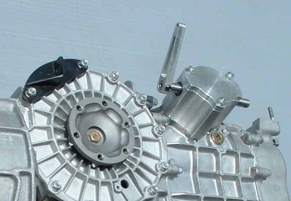

Not sure about what KEP can offer, and I'm afraid I haven't had a price from Renegade, but it looks like an expensive kit. As Lynn said the side shifter is probably brought in, from CMS (see Tim's post click here )
I have attached a photo Renegade sent me of it.

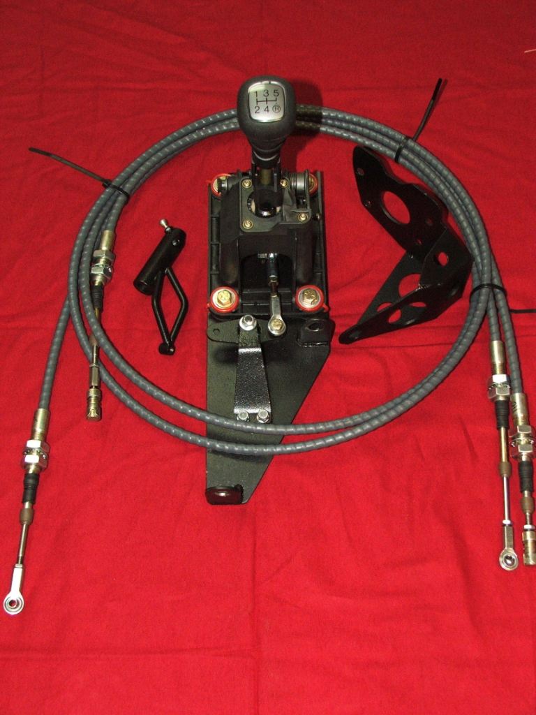

What we did is buy the shifter with the cables. Then we cut the hard parts off of the stock cables and welded them to steel rod which was then drilled and tapped to accept Morse stainless steel control cables of the proper length.

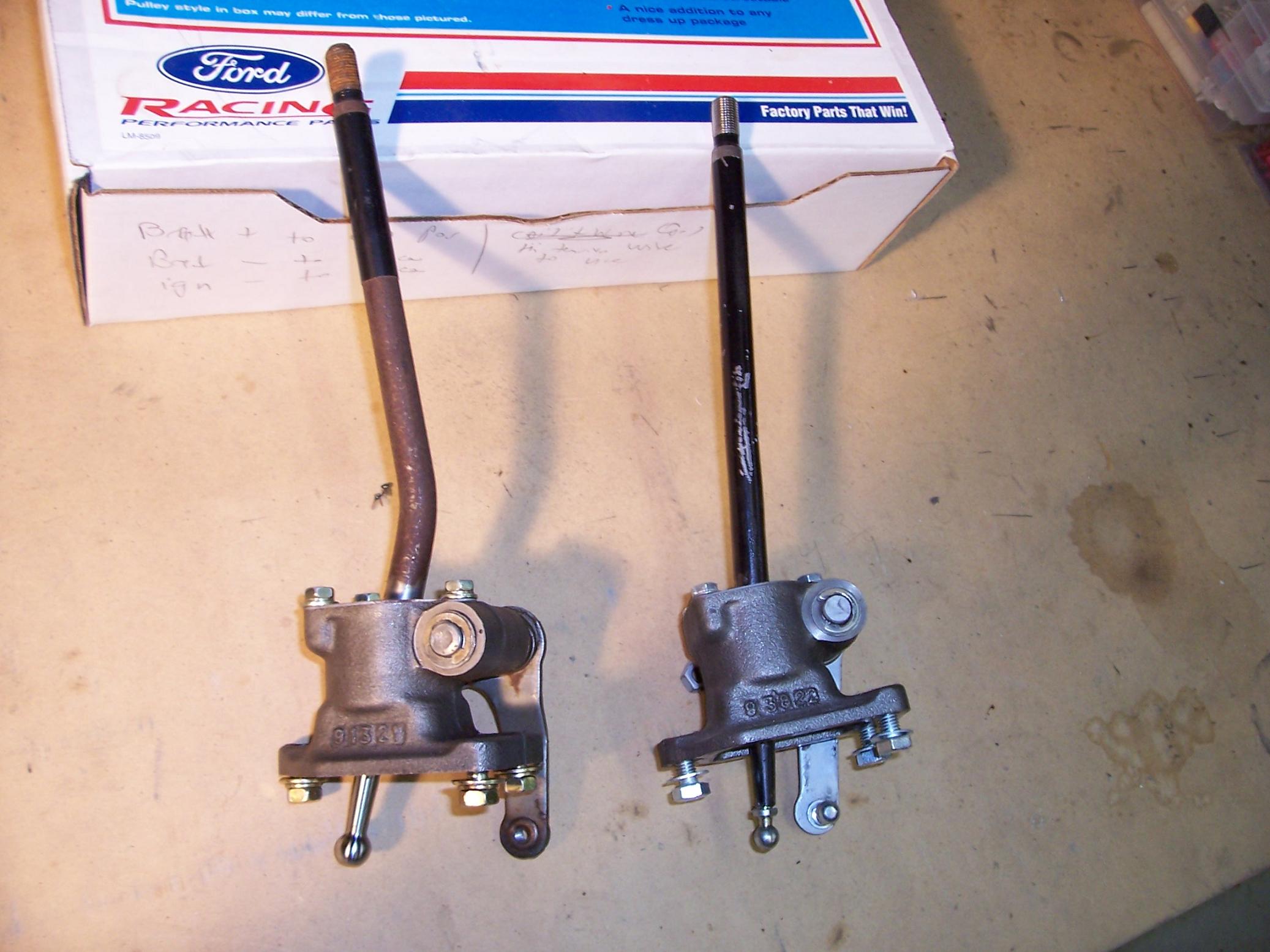

Not sure which Toyota this came out of...I assume if you
compare pictures a Tercel or Corolla shifter it might
become more apparent. As Lynn says...they're pretty simple
devices once you look closely.
Here's a stock Toyota shifter and one from CAV (?).
In addition to straightening the handle (?)..looks like the bottom ball was cutoff and shaft threaded for a Morse cable
MikeD
