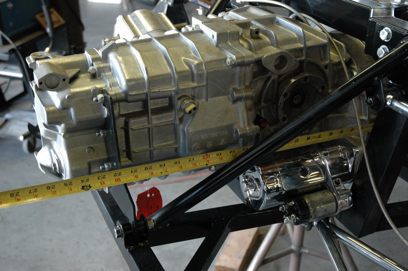

Mendeola sequential 4 speed, every bit of 32+ inches long.

My g50\52 at 26" long. Picture adding another 6" to fit a Mendeola [img]/ubbthreads/images/graemlins/lol.gif[/img]

And if length wasn't the issue, if you look closely, there are other issues involve with the Mendeola that won't allow use in a GT40 without major modifications.

Is you car running?! Way cool! Did you shorten the bell on your G50/52? I agree the Mendeola would verge on silly to stuff it in the MK1 but I personally think anything over 550hp and torque is for hero's or pissin' rights, because I wouldn't be able to use it! I am referencing Ricks car which had the G50/52 and the cable shift out the rear as you saw in person. I have a G50/52 with a stock bell that measures just over 27"plus the shift shaft which I estimated to add about 3" with the cable. In this scenario, 31" would have cleared my bodywork.
How heavy is the Mendeola?
When is your narley beast going to hit the road?

Yes, the bell housing was shorten 1" and a modified nose piece. If you look across the other side you'll see the top of the side shifter housing.
The weight on the Mendeola(4 speed), if my memory serves me, is about 150-160 lbs, plus oil.
