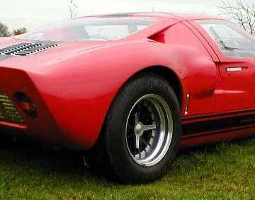

Ian,
here are the notes I made regarding my leakingRHS. You will see that I moved the wheel out 4mm, with my 255/60/15 tyres they are still within the wheel arch at the top. The way the wheel arch curves inwards as it goes down, a fair bit of tyre shows outside the arch once you get toward the wheel centre anyway, so the 4mm didn't make any difference for me see photo.
Just one other thing, you said that the LHS had free play when the car is at rest. Then you said the RHS was tight. I presume this means that the RHS is binding before there is any droop. If so, that is really bad because on rebound the drive shaft would physically push the transaxle sideways.
Mine was ok neutral and bump, but binding on droop, and the roll pin was broken, so if that is anything to go by, yours would be too.
Phils suggestion about the transaxle being off centre is also a good point. You do have play in the RHS at some point dont you? If you dont, you have to check with the suspension disconnected in case the CV joint has a problem.
"Sept 04 Leakage from OS seal. Roll pin is broken, seal looks ok. Oil coming along spline and into centre of rollpin?
1/10/04
Ref leakage from RHS Transaxle.
Roll pin that secures Drive Shaft Hub to gearbox output spline was broken. Think the leakage was along the spline and out the roll pin. The roll pin has broken because the suspension closes the drive shaft on full droop and the load is taken on the roll pin.
With the roll pin out, 1/3 to half the 6mm hole is obscured, suggesting 2-3mm interference. So increasing track 4mm per side at the rose joints is in order.
The rose joints have a 5/8" unf thread pitch 1.41mm so 2.5 (3.5mm) to 3 turns (4.2mm) should suffice.
Did 3 turns, have 11 turns (15.5mm) thread still engaged on Rose joints which is ok.
13/11/04 Did knockhill trackday, no leakage."
Hope this helps
