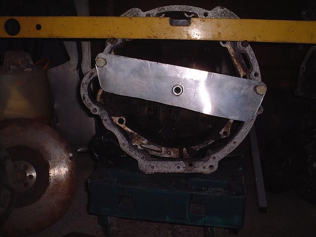

Re: Making a gearbox adapator, is this okay
and these
ID:	21496  Click image for larger version
ID:	21497  Click image for larger version
ID:	21498  Click image for larger version

Okay, made my adapator today and welded on so looking good for now.
The adaptor is the front cut off my scrap Rv8 bell housing, milled down to 1" thick.
To align I got a piece of 1/16" ali, then drilled to the dowels on the engine block, then using a ball pein hammer gently tapped out the crank centre.
Bolted this to the adaptor and centred on the first motion shaft, clamped in place and welded up pic 2 (prior to welding).
With a 1" adaptor ring the first motion shaft on the box is long enough to fit inside the ring gear flex plate spacer so I am hopefull that I can just bolt the audi flywheel straight on.
NB/ welding was horrible.... the poor grade of cast material put ash on the TIG tunstun, even with the gas cranked up... never seen that before !
Once I have finished I,ll post a few more pictures.
Regards Mark
