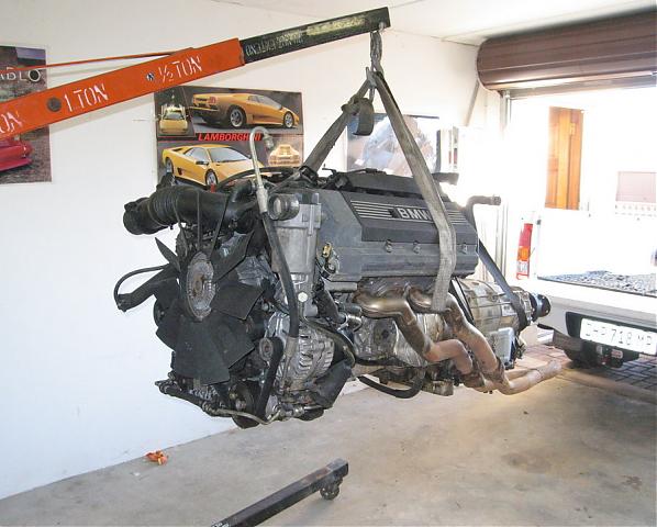

Hi Guys!
Getting a Diablo drive train will not work as then I would have to get the Lambo motor... That alone could cost me more than the entire project budget!
I have already bought the motor, picked it up for a bargain (literally next to nothing with all computer boxes, aircon, alternator, starter, wiring harness etc...) so now I’m stuck with it. I’m told its a pretty bulletproof and powerful motor though... time will tell.
I guess if I would have to advise anybody then taking the entire Audi A4 engine and gearbox would be MUCH easier, and you have a choice of engines. It seems however that most people are using Ford motors in their builds, have not seen any Audi powered mid engine replicas...
Damian

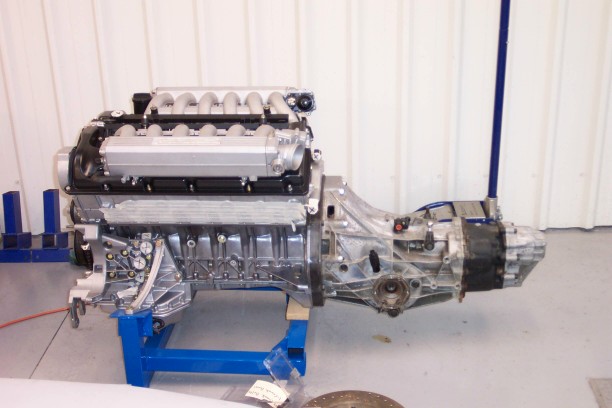

If you have already got the engine then I guess you are a bit committed down your current route.
There is a GT40 rep with an Audi V8 in it as I have seen pics of it on this site.
I am suprised the Audi V8 is not more popular with mid engine kits/replicas as it is nice and short, light and will bolt directly to an Audi 2wd transaxle.
If intersted here is what the V8 looks like bolted to a transaxle about to go back into my Lotus.
Hilly

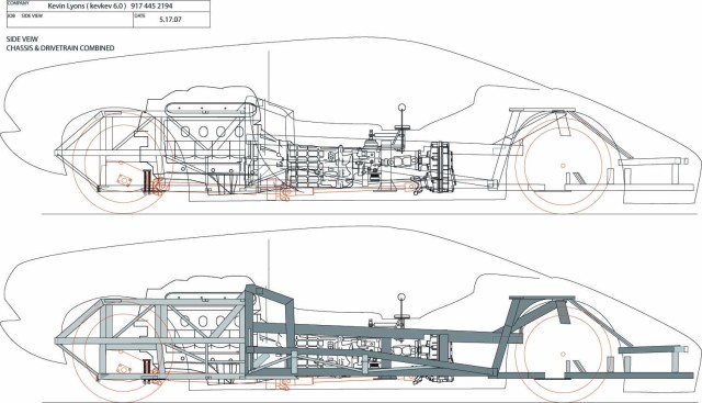

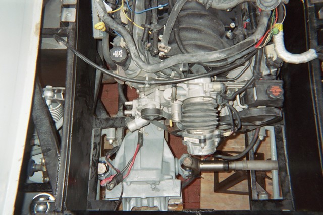

Damian, It can be done have a look here kit c e n t r a l :: Diablo Builder Support Group
you may need to join up but it will be worth it, and from another builder a BMW with a audi 016 hope these help. how long is your BMW motor, i'm doing a Lexus v8 with 016 in a countach, lexus is about 720 long.
Regards
Lambo
Hilly

If I recall correctly, the Audi V8 is not at all light weight. Seems it's some 150lbs heavier than a SBF. I have the engine weights listed somewhere; I'll have to search them out.
Andy
Not sure what the SBF comes in at, but the Audi V8 is about 200KG with all the bits on as the block is alloy with no steel/iron cylinder liners.
I have got a complete dis-assembled engine at home so I'll try and chuck it all on a set of scales during the week to get a better answer.
Hilly
The Audi V8 option looks damn fine actually, and it 'is' lighter than a cast block unit. The less buggering around making up adapter plates etc, the better.
Graeme, that chassis setup with the V8 heading south/north looks good. But it does seem an excess of weight. If a 'standard' type of transaxle is used, and the motor in the North/south direction, the output shafts would be in the same position as they are now using the separate diff unit. It would be a good idea though for a 4WD setup.
Wanni, if I had 30k Euros, Id snap up that driveline quick as. I would rework my chassis to fit the engine and take out the V8 thats going in there. Thing is, at 30kEuro its about the same amount as the total project so far!! Have you got a cheaper, used unit you know of?? hahaha!
Hi Bruce, I seriously looked at the way KEVKEV did his diablo with the engine about faced, i guess the only added weight would be the vdrive unit and the driveshaft etc so it probably added another 50lb ?, nothing the addition of a turbo would not sort out, the only concern i had is the diff sits low down in the picture so the axels would seem to run uphill alot, but it seems to work for him.As far as the audi v8 it would be nice something out of a R8 would be nice, all i need is a way to pay for it, what would a 20yr old son fetch on the market???.
Best regards
Lambo
