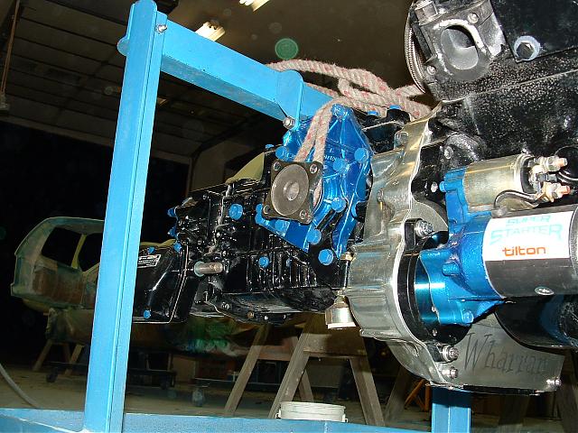

Ron,
If it is a ZF that was sourced from or for a Pantera, it should have the U joint axles/flanges. The half shafts are made up of all standard Spicer brand parts including the sliding spline, with the exception of the tubing that sets the length.
