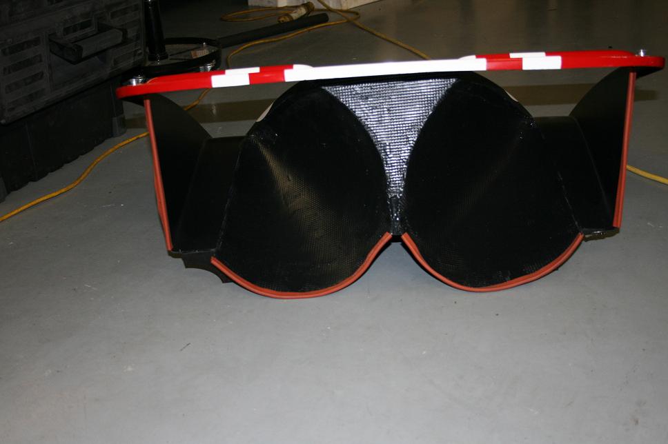

Kevin are you going to do this?

Yes or some variation of it... Not quite sure how it will play out quite yet
I do love how you made your work

My reason was to get the hot air of the foot well and it does a good job at that. It was done to spare expense of purchasing a better piece as Mike Drew has posted and have it repainted. Someday.....

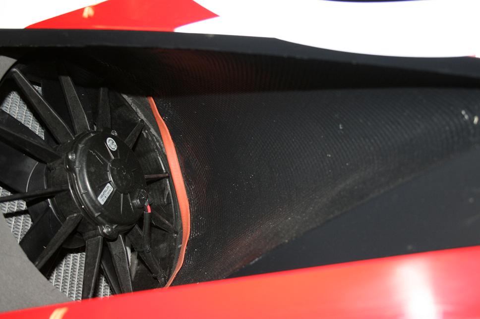

Here is mine with the Olthoff modification
