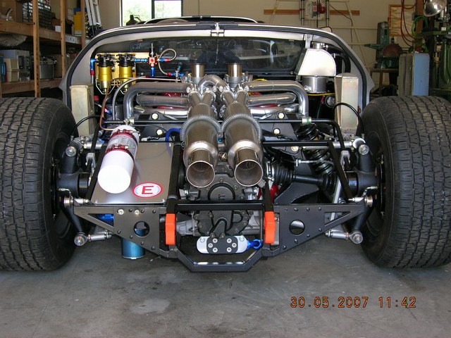

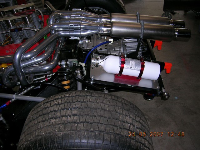

The next aspect is the engine bay system. This installation is based on a 5 pound Safecraft Halon unit. Obviously there are other options but in general, they all install basically in the same manner.

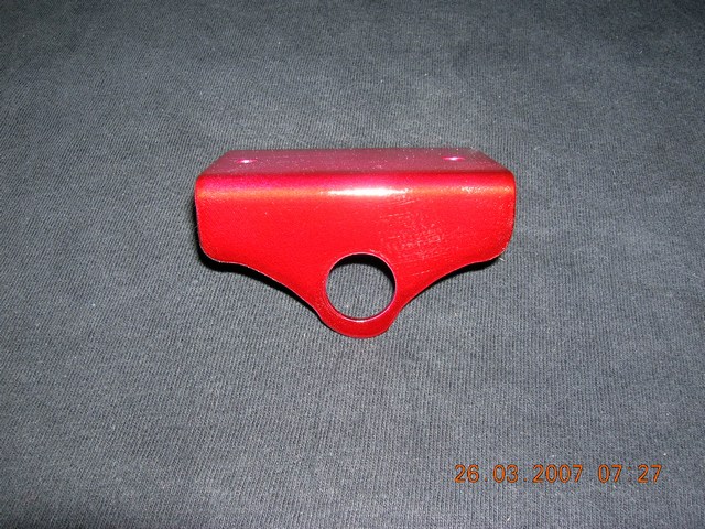

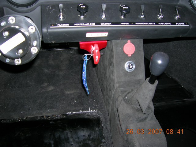

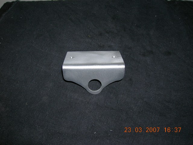

Make a bracket as shown below and mount it as shown. Once again there are few places to mount the release handle. One other option is to remove the 12 VDC adapter port and install the release handle there. The cable is then routed under the transmission linkage tunnel to the rear.

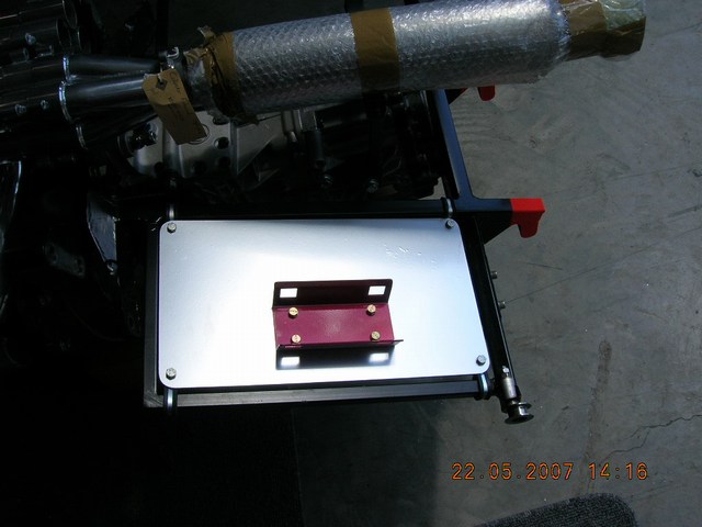

The mount for the bottle is the left side of the engine compartment. Using Adel (P) clamps, mount the aluminum plate as shown.

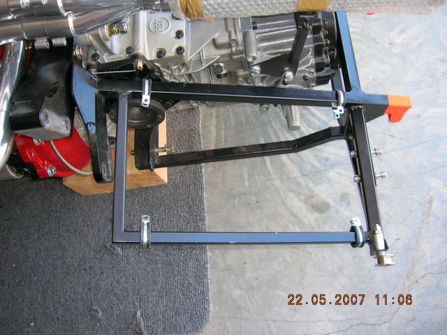

Route the discharge tubing as required. Custom brackets will likely need to be fab'd. Make sure all tubing clamps are of the rubber or plastic coated type. I use aircraft grade Adel clamps. DON'T use wire ties!
