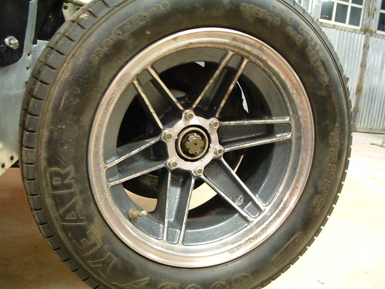

David, the wheels are magnesium that have been steel wooled and painted and clear coated. Awful, but fixable ! Probably not suitable for racing any longer, but I have some extras that will do nicely. What size wheels and what type of tires do you use ?

David, this is a better picture of the wheel.

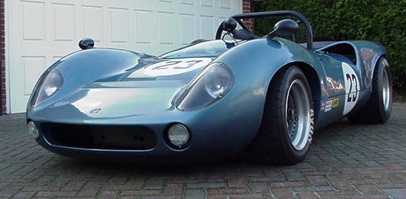

David, this is what the "Sunoco" car used to look like.
Also, I need a new left side fuel cell. It looks like a caterpiller, with indentations for the pod ribs.

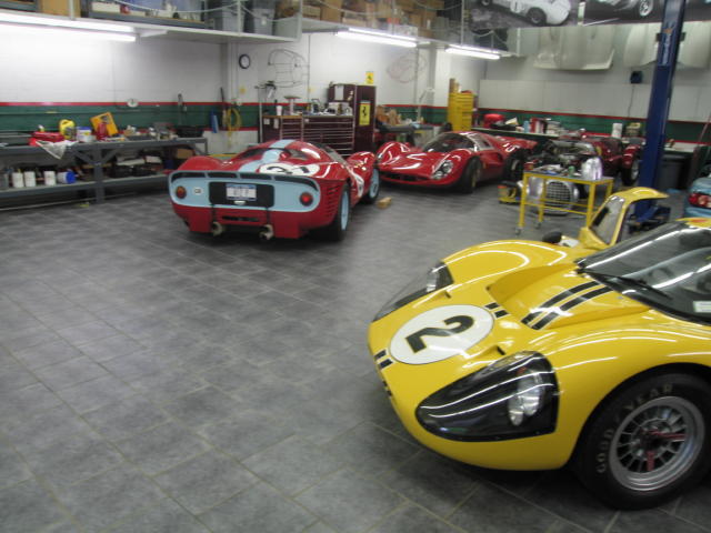

Hi
I have an original Specialized Mouldings Nos Coupe body but my Spyder Body is long gone.
(Unpainted body hanging on wall)

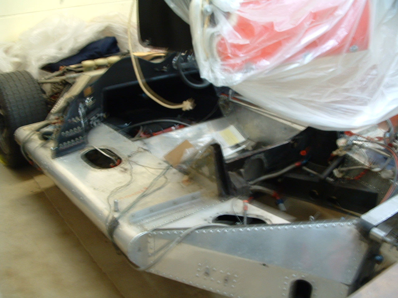

The car was wrapped in plastic, as if in a baggie ....!

Johan,
Something looks different in the hub area of your ft wheel, I think it is the center hole is smaller size than I have seen. There should be a dust cap on there as well, mine were crome plated. some owners use a "Nylo" seal behind the nut and run without a cap.
The "correct" MKI wheels are 8" wide but the spokes do not taper closer together as they go outward to the rim, they stay parallel. Later wheels in 8" taper as in your photo, and the spokes run longer into the wheel rim like yours do. Yours look like the 8" wheels. There is a 9" spoke wheel like yours, the difference is, the spokes stop at the first point they meet the outer rim and do not continue down the side of the rim drop like the ones in your photo.
The Lola Wheels have been known to break, I saw one break on the front straight of Sears Point, CA, it broke in the rim lip area, the other one broke in mid-spoke, actually it cracked and was taken off the car. Several T-70 owners will not trust the original wheels and run copies, old Halibrands or Jongblood wheels.
On my car I have an original T-70 coupe wheel I can take a photo of if you want to see one. Supposedly the coupe wheels have a lip on the edge of the rim where a tire machine tool would rub. The Can-Am wheels seem to have just a raised lip there, but the coupes have a cuved lip similar to a steel wheel that you almost could attach a clip-on wheel weight to.
I have Halibrand wheels that say "Mecom Racing" on the backside and also the backspace: 2.5" ft 4.5" rear, and the wheel width: 9" ft and 12" rear.

Johan,
Pardon me, but your photos are blurry!
If you are using a point and shoot film camera, make sure you hold it steady for a longer time after you press the button. My first photos came out like some of yours, I did not allow enough time for the camera to autofocus and snap the photo before I lowered it.
Perhaps it's something else, but I'm wishing they were clearer so I can really check your car over!!! [img]/ubbthreads/images/graemlins/smile.gif[/img]

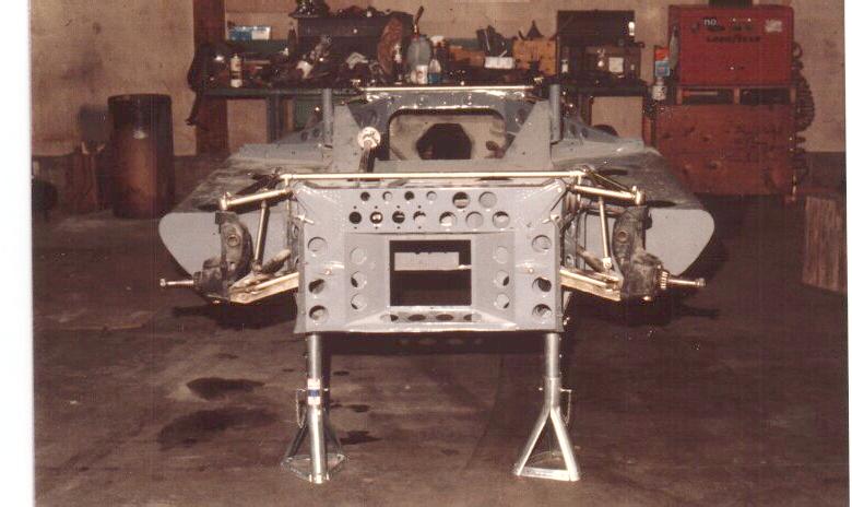

Thanks David. My car is a MK II, not a MK I. The wheel center has a "cap" covering the bevel cut out for a knock-off. I'll take another picture of the wheel without this. I'm sorry to hear about the original wheel problem. I have three sets of original wheels. Crap ! Two sets look like these. This is the car at a car show in 1980.
Sorry about the crummy pictures. I agree that they are blurry.

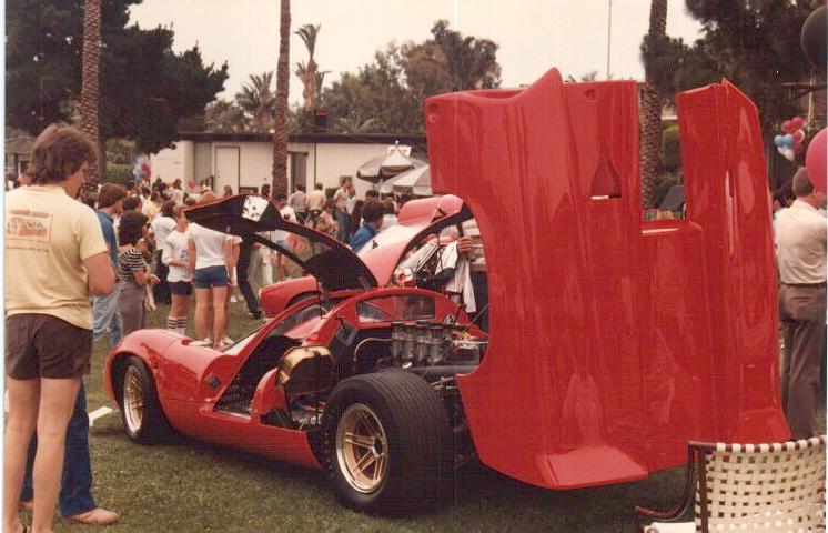

Ben, she just does not care for the car stuff. Oh well, at least she lets me have my fun. They all look the same to her.
