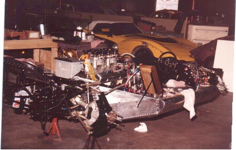

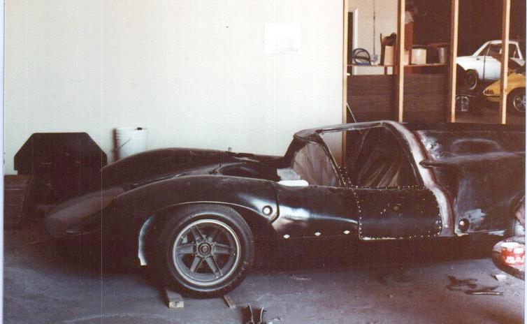

these pictures were all taken in 1979 or 1980

Hi Johan
This photo is the best I have seen of SL71/34 showing the original AAR colours at the 1966 Bridgehampton Can-Am.

Great Photos (unlike mine !), thanks for those Rob !
Good to see the color scheme.I'm trying to determine if my car had a "dashboard structure" like the number 8 Jerry grant car, or the kind with all the holes in it, sort of like the recent T70 attributed to Surtees that was for sale not long ago. I'm trying to accumulate the parts to return the car to spyder configuration. The number 8 car is obviously not the #30 car because of the different roll bar shape.

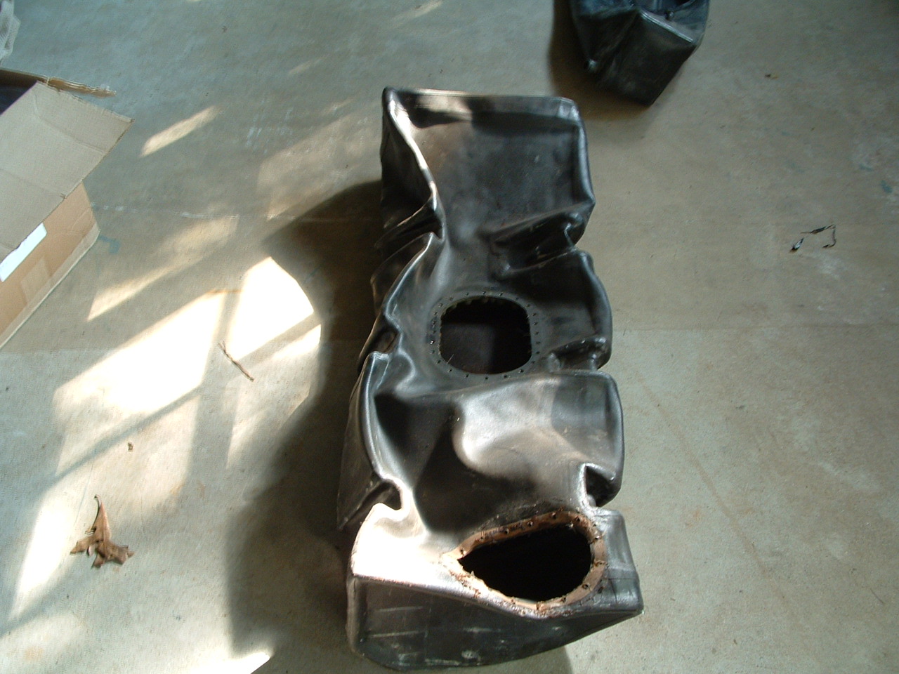

The fuel cell that burst it's bubble.

Above can be seen the bubble, below, the top side of the cell.

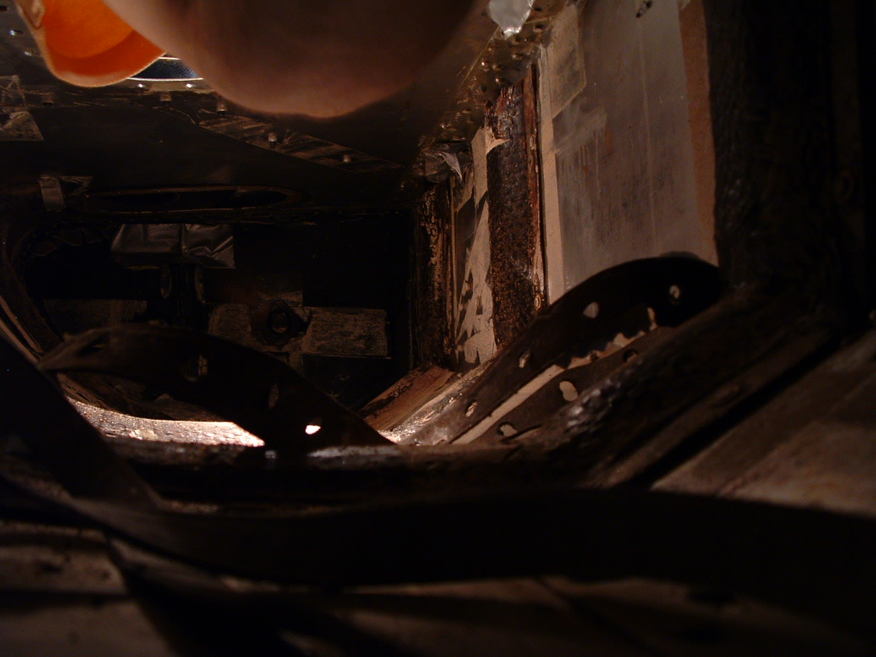

this is a shot inside the sponson, where the cell fits. I dropped the camera down through the fuel cell access hatch. The ribs are not rusty, they are covered in some sort of dried goo.Sorry for the fingers.

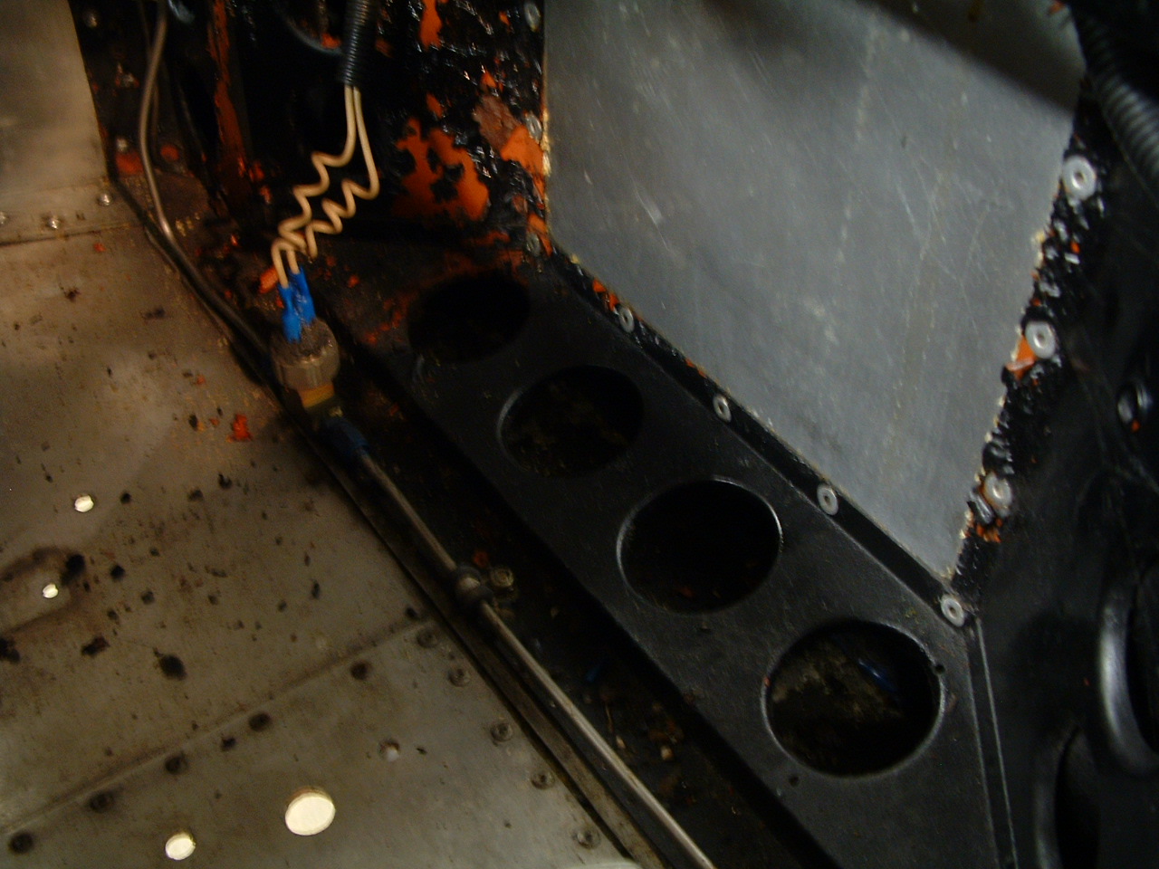

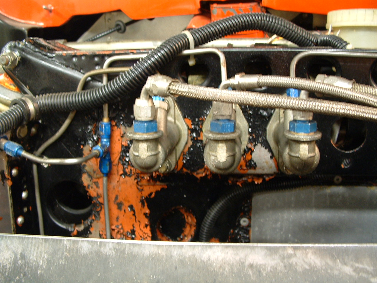

This is the front bulkhead where the fluids have been leaking out, lifting the paint.
