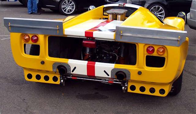

Big-Foot,
that`s interesting, thank you, just trying to imagine the car with such rearlights.
Any idea as to what other cars had the rearlights shown below?

Hi Marcus
I googled Landrover Series II photos and found a good 3/4 rear pic of its tail lights but couldn't repost it here. Anyway its lights look identical to the yellow Lola above ie same 2 relieved screw holes, high pointy dome and concentric circle pattern (you can see this quite clearly on the hi-res pics of the purple car on the Lola Heritage site).
As far as I can tell they also look the same as the tail lights on my 1:12 Tamiya T70. If it was me, I'd hapily go with the Land Rover lights. That said, I haven't looked for picutres of the Volvo lights to compare. Don't want to look at any Volvo parts...

The rear lights on Carlos's car above are "Lucas L691" as fitted to Austin Healey and Hillman Imp. £19.99 each, Various colours and single or double contact ( for stop/tail). From
Vintage and Classic Lucas Car Spare Parts and Accessories from the UK
I know as I fitted then
They are actually quite different to Land Rover ones. LR are a bit smaller diameter and have a much more pronounced point to them.

yep, can cofirm what darren says . if you are scourcing Healy spares they are for the bj8. steve

So that explains why the tail lights and the indicator lights are different on mine... Looks like the red tail lights are the original ones and the Orange ones are off the Landy - I'll post a pic for confirmation.
