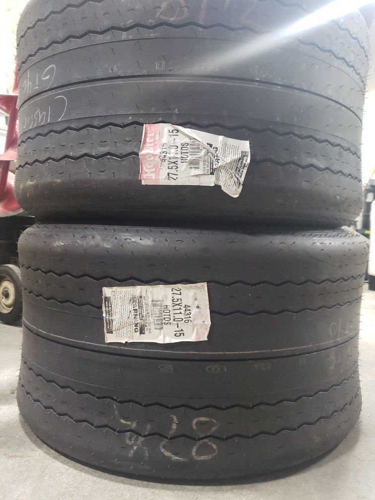

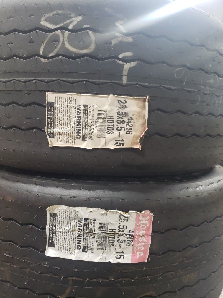

Hello,
I have a replica Lola T70 that is rarely used and only driven on the street. I have been looking to replace the tires with something more appropriate for the car and found a great deal on a new set of Hoosier Vintage T.D.S tires. The model numbers are 44286 and 44316. I am a college student and I am trying to keep the Lola running on a very limited budget. There are few inexpensive tire options in these sizes so I am drawn to the option of using these racing tires.
What would be the downsides of using a tire like this? I assume that they wont last long but I drive the car only a few hundred miles a year.
Any advice is appreciated and if this is a stupid idea feel free to say so.

I would say for your intended use they're OK. They at least have some tread pattern although I wouldn't get caught out in the rain. Assuming they are technically DOT approved, but may have 'for competition use only' on the sidewall ? Not sure about liability if you're involved in an accident. Wouldn't worry about wear with limited use.

Thank you the liability is a concern and something important for me to consider. They do have that warning on the sidewall. That having been said, this car is terribly unsafe and I doubt I would survive most collisions.

I just ran 157.458 mph on the 27.5" x 11" Hoosiers that you posted a picture of. They are race tires so they are not good in a heavy rain and they are susceptible to damage from debris, potholes, curbs, etc. I wouldn't run them on the street. Where did you get that Stirling Moss quote?

Wow that is some serious speed! Must have been quite exhilarating! I will never be reaching anywhere near those speeds in my replica it certainly is not built well enough for that.
Thank you for your advice, it’s good know that at least these tires would be a good option should I ever head to the track. It seems like the seller acquired them in some type of ‘fell off the back of a truck’ incident at Sonoma Raceway. So if anyone lost a set of these there... they do say GT40 in chalk on them...
