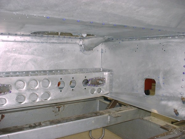

Darren,
I know a pal of mine uses purple rivets on his Lola but are they standard fare in the UK too??

Darren,
Hi Fran. Yes they are standard fare here in the UK too. The different colours denote material and strength for aircraft specs. The purple ones are , I think, Monel. Colours codes used worldwide as far as I know.
Marcus. Yep the floor goes on last on the continuation cars. Engine mounts and rear susp towers in the jig first, then tied in with tub sides, then front top beam and front panel, dash support, outside skins on tubs then turn it all over and do the floor... something along those lines anyway. I'll post some more pics if you like.

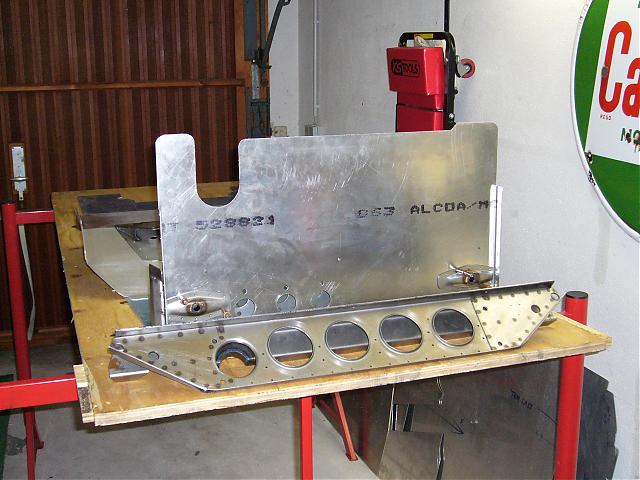

Marcus,
That looks like nice work. I know you will have alot of fun building it.
May I suggest that you purchase a copy of the "AC 43.13". It is a manual containing FAA approved data, concerning basic aircraft maintenance.
Chapter 4 is an excellent resource on all things sheet metal and riveting.
It can be purchased at any good book store or online. Just google AC 43.13 . I guarantee you will find it very useful.
Looking forward to more pictures!
Cheers,
Scott
