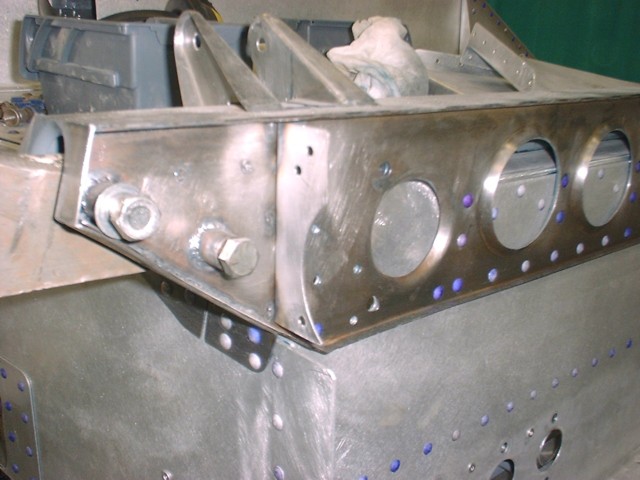

Here are a couple more pictures for you to browse Marcus. Hope they help...

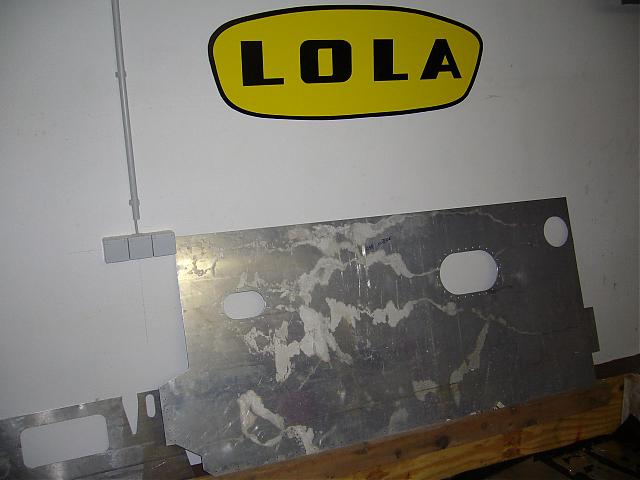

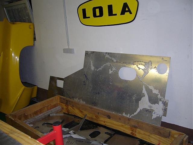

Still in the process of fabricating all the panels from flat patterns before building the jig and mocking the whole thing up.
Flat pattern of left side pod ("gas bay"):

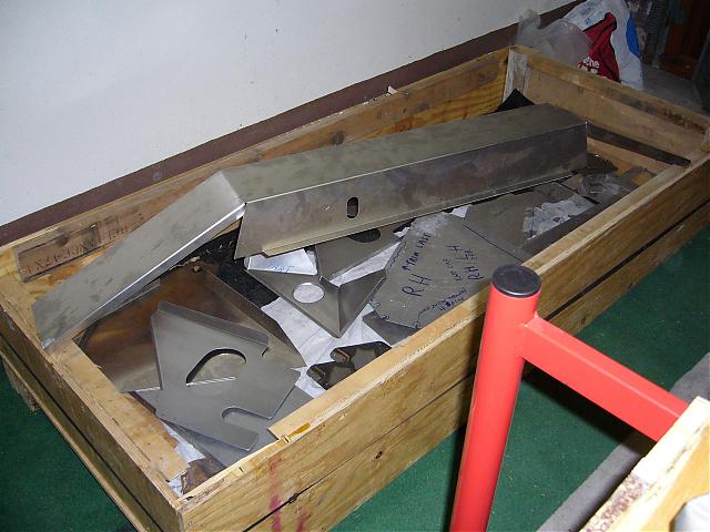

Hi Marcus,
I must be losing my eyesight in my old age as it appears that your friend Darren's tub has a mistake. In the top picture of frame #25 the outboard most lightning hole looks as if it is dimpled 180 deg. out. Like it is fouling (chaffing) on the front bulkhead. Should that particular lightning hole have been dimpled in the same direction (fwd), as the other two inboard of it?
Its late and I have been crawling around airplanes since early this morning, so excuse me if I'm mistaken!
It will be interesting to note the sale price of SL76/147, as this will be at least some indication of the value of what you will accomplish in the end!
Scott
Get some sleep & have another look Scott, there is a tube behind that opening for the steering column to pass thru.
Jac Mac
Scott
Scott,
for having had such a long day you´ve still got very sharp eyes...
The backward flaring of the outer hole is correct while the other holes of the front upper bulkhead are flared forward.
Best,
Marcus
