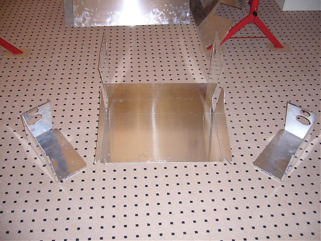

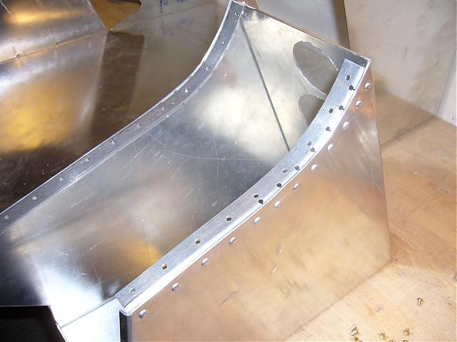

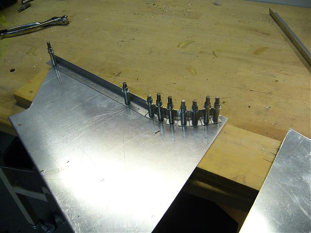

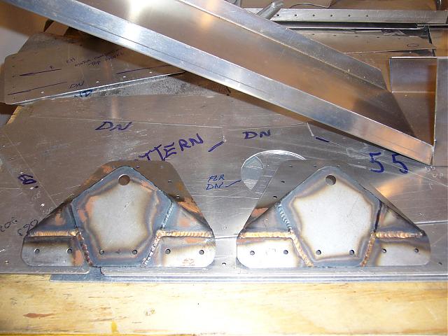

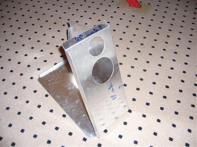

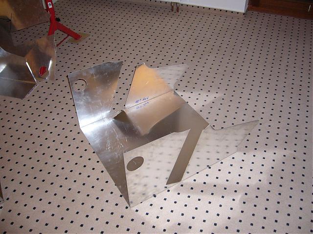

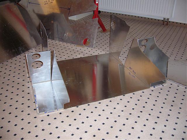

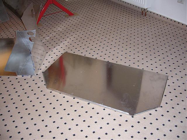

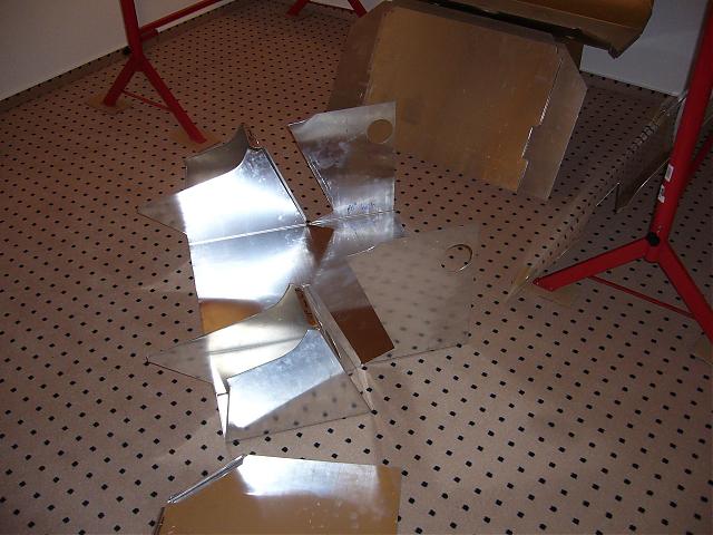

Chassis build is progressing rather slowly at the moment as my wife and I have to look after my father from time to time who is suffering serious cardiac problems and underwent surgery (bypasses) recently.
Nonetheless, I managed to do some work on the radiator housing and here are the freshly fabricated panels, still need to flare the holes:
ID:	25651  Click image for larger version
ID:	25652  Click image for larger version
ID:	25653  Click image for larger version
ID:	25654  Click image for larger version

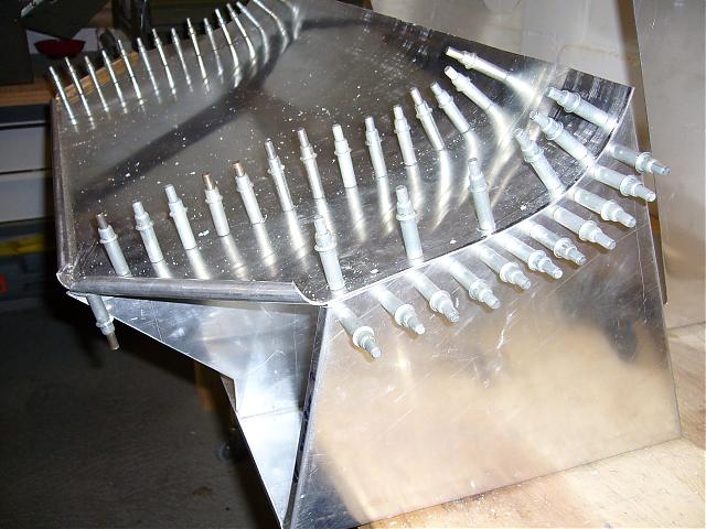

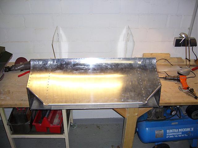

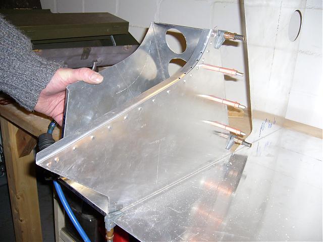

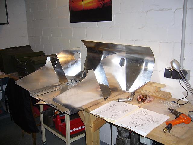

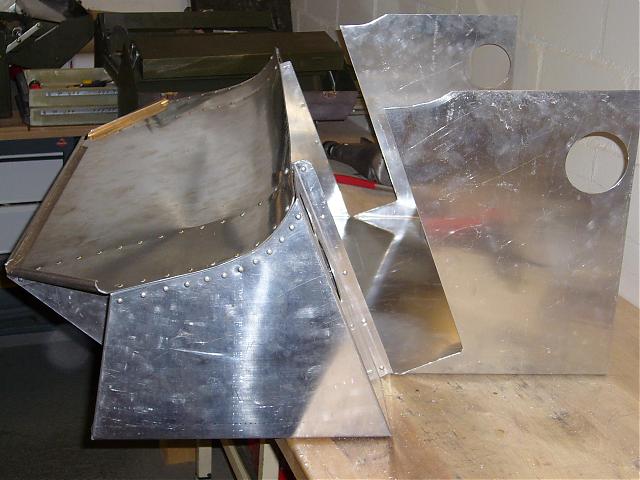

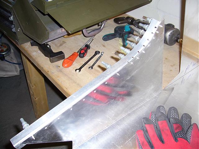

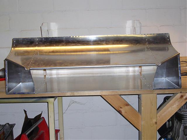

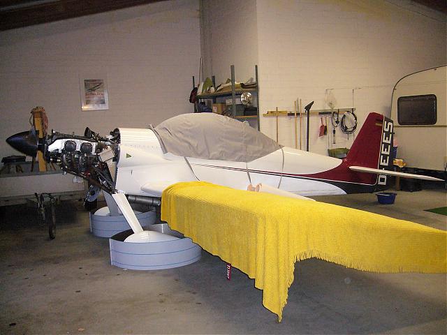

Sooo...after having treated myself to some thorough lessons in riveting by professional metal aircraft builder Mathias Lenz (www.lenzair.de) we started assembling the radiator housing.
It took us much longer than expected, we had to spend two full days. Here is the outcome:
ID:	26633  Click image for larger version
ID:	26634  Click image for larger version
ID:	26635  Click image for larger version
ID:	26636  Click image for larger version
ID:	26638  Click image for larger version
ID:	26639  Click image for larger version
ID:	26640  Click image for larger version
ID:	26641  Click image for larger version

Old 01-21-08, 10:46 AM   #51 (permalink)
FRPGUY
3 Tenths
Join Date: Jan 2006
GT40: Norwell, Mass. USA
Posts: 376
Re: LOLA T70 scratch build...
Nice RV Marcus!!!
FRPGUY is offline
Old 01-22-08, 04:30 PM   #52 (permalink)
marcus's Avatar
marcus
Gold Supporter
Germany
Join Date: Jan 2006
Location: Germany
GT40: LolaT70 project
Posts: 423
Rep Power: 7 marcus is just really nice
Thanks Bill, wish it was mine.
Hereīs the story behind this painstaikinly buildt RV:
Van's Airforce German Wing
marcus is offline

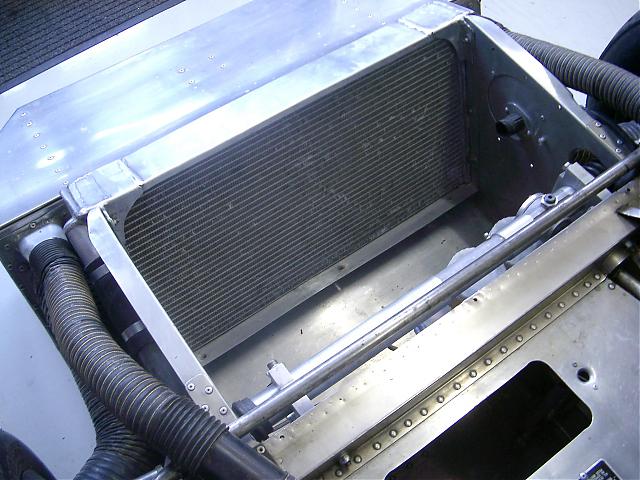

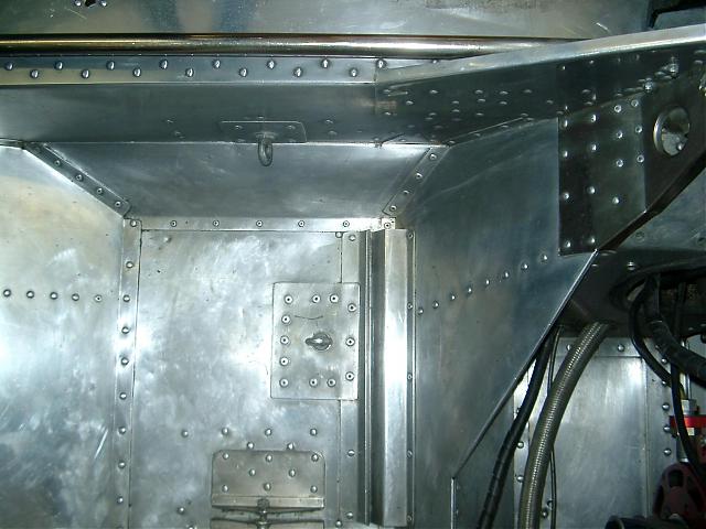

There is an important question for which Iīd like to ask for your knowledge, all you aircraft professionals, master riveters and Lola tub magicians out there:
When you get to certain areas which are hard to access even for your buddy holding the bucking bar, wouldnīt it be a good alternative to use cherry lock rivets? Any advice highly appreciated.
To my knowledge they can carry at least the same loads as normal rivets and they can be fixed by one man alone. Lola seemed to have used cherry lock rivets in certain areas, see below pics of SL 76/147īs original chassis:
ID:	26792  Click image for larger version

For your intended usage. you can certainly use Cherry rivets.
Make sure you use a cherry depth gauge so you don't waste rivets.
Last time I checked they were better than $2.00 a shot, although I must admit I don't pay attention to their costs, as we have drawer upon drawer full of them in the hangar!
From the pictures you have posted (resolution/close-up of the Lola) it is difficult for me to identify the type of pull rivet they really are.
On a separate note, I am concerned with the curved angle you have made in what looks to me as your radiator inlet. A more appropriate way, would have been to use a "shrinker/stretcher" to put the curve in that piece of angle. All those holes so close together have removed quite a bit of strength and may cause cracking between holes/angle itself.
Just a thought.
