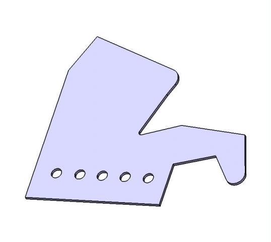

I decided to reevaluate my strategy in terms of chassis building and to go another route.
Instead of using my set of flat patterns for marking, hand cutting, drilling and smoothing/deburring every single panel all the patterns are getting digitalised by a special CAD/CAM-software for easy laser- or watercutting.
That also makes them easy to reproduce just in case.
So hopefully one day I end up with a CD containing the complete MK3b chassis including all drawings, parts lists, shopnotes and detail pics, to serve me as a helpful documentary.
This software is also able to make drawings and 3-dimensional views of each single panel.
Here´s one of the panels from the rear shock tower assembly, still missing some holes and bend lines, but you get the idea.
Best,

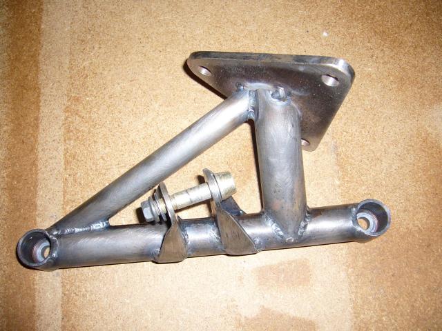

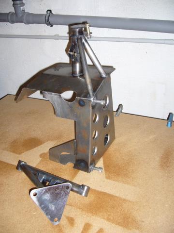

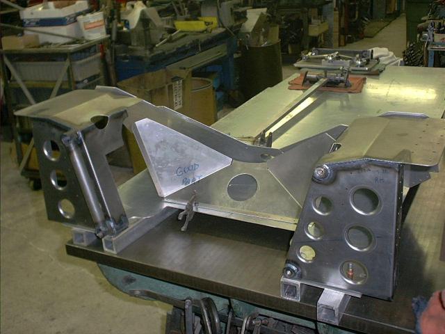

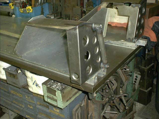

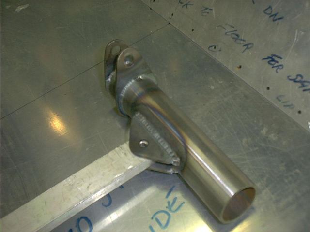

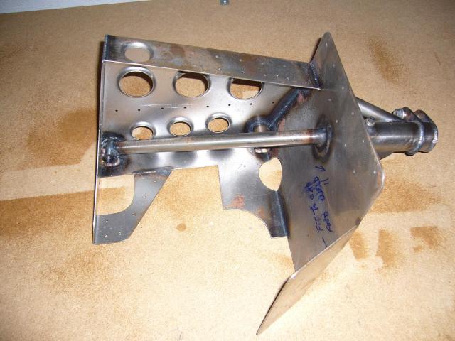

Some progress to report here.
While examining the panels and workshop notes of the motor mount bulkheads they turned out to be a very complicated part upon which a lot of the chassis´s strength and safety hinges.
Lots of different angles etc. involved and they also carry the rear rod towers.
So I decided to have them done by a reputed Lola specialist who has not been doing this for the first time. He is a master chassis builder, located in Simi Valley. CA. His name is John Mason and you can find him under
Mason Engineering - About
The bulkheads are in the making and are soon to be shipped, here are some pictures:

thank you. The credits for the bulkheads all have to go to John Mason.
Since the finished bulkheads arrived yesterday at my doorstep in a crate together with many other bits and pieces I´ll post detail pics of all the stuff tonight.
Best,

Hi everyone,
another load of parts has finally arrived at Stuttgart´s Airport Cargo Center.
Opening the crate felt a bit like gift giving on Christmas Eve...
Among the "Hen´s teeth"-parts were the long awaited Motor Mount Bulkheads, the front lower control arms as well as the hard to find gearlever mechanism with its rod linkage.
I´m very pleased to say that the bulkheads and the engine mounts as well as the control arms are made to high quality standards. My neighbor, who is an engineer at the nearby DAIMLER plant being in charge of quality control for the S-Class Coupe, confirmed the build quality after I happily presented the parts to him. Needless to say I´m also happy to got hold of the gearlever mechanism, which is original Lola.
Here are some pics of the Motor Mount Bulkheads with the radius rod towers:
